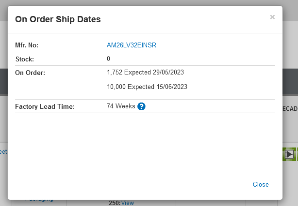

Look at AM26LV32E. This is a quad high speed diff line receiver (32MHz) for 3.3V
No need for level shifter....

  Volhout said  Tinine,
Many thanks, guys

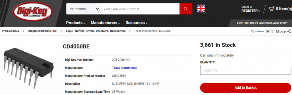

I have lots of pending orders for my controller and so the big problem right now is to design with components that are not in short supply:
-Propeller P2...no problem
-Pico...no problem
-Older DIP devices...no problem
Stuff that I would ideally like to use:
Problem
Craig

For a line-receiver, I'm really comfortable with the MC3486, been using it for years. For the level-shift, the big suppliers have plenty of CD4050Bs. I don't see much risk, here

Tinine
Joined: 30/03/2016
Posts: 1646
Posted: 01:04pm 31 May 2022
These guys appear to be kicking butt right now:
I had a look on AE and grabbed 100 "CD4050"s, shipped for ten quid. Too risky for my controller but I'll test a few on my desktop rig.
