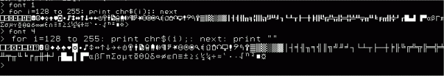

I'm trying to print DOS graphic characters under MMbasic for DOS version 5.070308 using chr$(nnn), like this
for i=33 to 255:print chr$(i):next
It only prints up to 127 "~" then nothing.

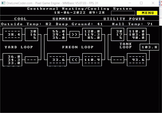

Give me a few hours (or maybe a day), Paul, and I'll send you a cut-down program which, using DEFINEFONT, can print this:
(This is from g8.bas, 3,400 lines of code, slightly modified from our last g7.bas just to get far enough to produce this screen.)
Here's the DEFINEFONT if you want to have a play. Lower case letters are replaced with PC graphics characters.

Note: code shown below is in upper case because the lower case "a"-"m" characters are shown as graphics after FONT 8.
Here's the template file from which that line drawing was produced:

I may be misunderstanding the issue but on MMB4W the standard fonts 1 and 4 already contain the extended CMM2 character set including line drawing characters without redefining anything.

It looks like the default font 3 does not have the characters above 127 defined.
enter
FONT 4,2 then try
PRINT chr$(177)
Font 4 has the full set. the 2 is scaling the size.

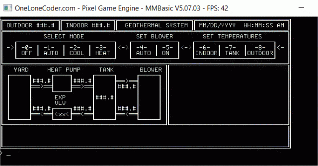

Version 5.07.03.08 is MMB4W (MMBasic for Windows), and I think the most recent version.
As Tom said back in post 5, fonts 1 and 4 have the PC drawing characters. In post 6, I showed that to be the case, printing characters 128-255, first using font 1 and then using font 4.

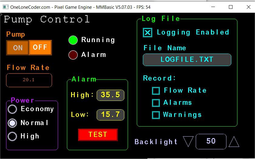

I also sent you the code which writes Geoff's guidemo, set for a 480x320 screen:
This illustrates the graphics capabilities of MMB4W.
