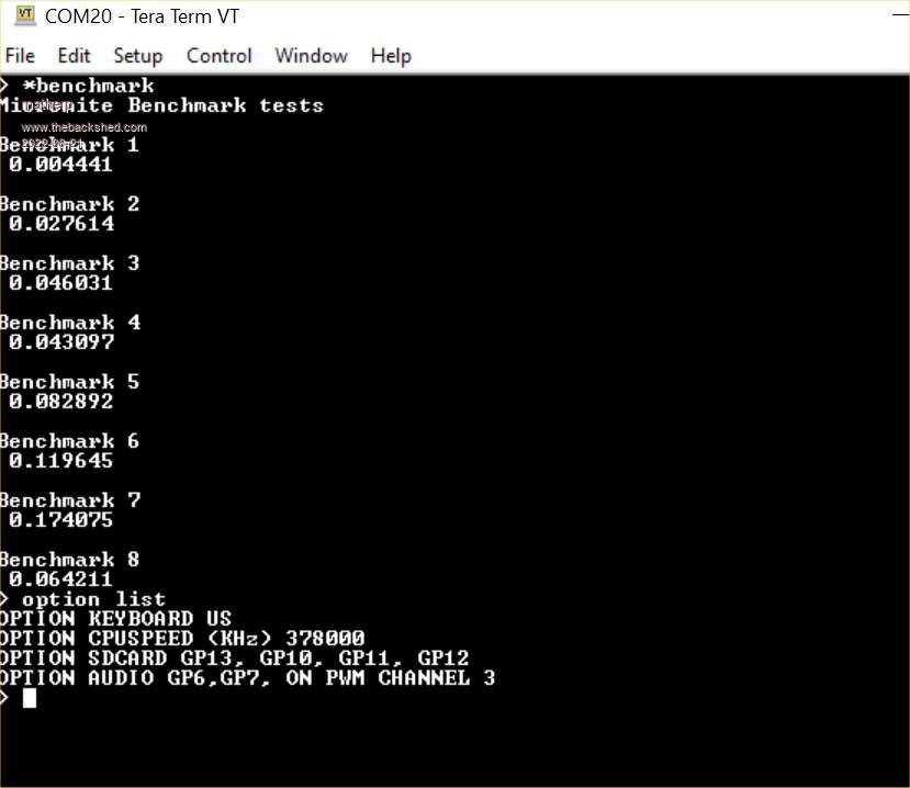

Bleep (Kevin Moore) has discovered how to underclock the flash memory on the RP2040 at boot allowing the system clock to run faster while still reliably reading the flash. I've then worked out how to make this flexible depending on the CPU speed.
Together these mean that we can now clock the PicoMite and PicoMiteVGA at up to 378MHz.
Testing the PicoMite at this speed I'm now seeing The simple speedtest showing more than 257,000 basic lines a second and grainbench at 6441
I've attached the files below for testing - please let me know if you see any issues on any peripherals (I2C, SPI, PWM, etc.)
