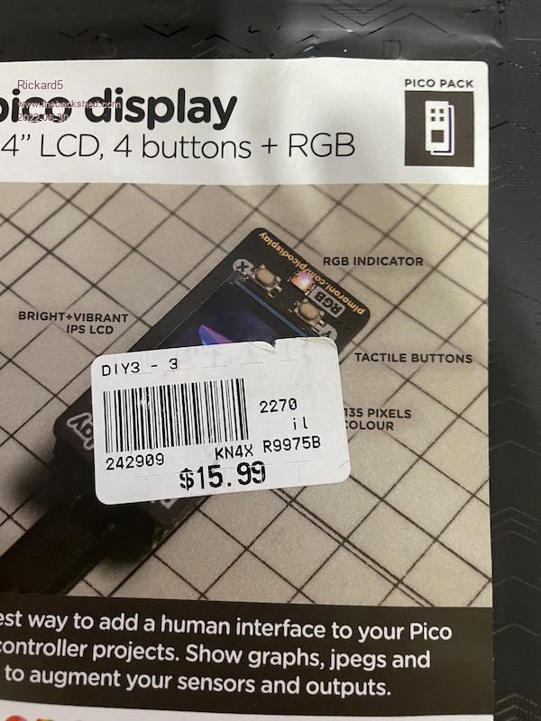

Hello Everybody, today I was searching though parts boxes looking for something and came across a Pimoroni pico display pack I don't even remember buying. Must have been one of our many post corporate Hydraulic lunch shopping trips to Microcenter. Anyhow has anyone ever got one of  These  working with MMbasic as a Picomite? I have a Perfect Project in Mind for this tiny screen. thanks in advance for any info! Here is a Link to the Pimoroni product page
Thanks Guys
Rick

Should work nicely. Setup (untested)
OPTION SYSTEM SPI 24,25,1 or OPTION SYSTEM SPI 24,25,6
OPTION LCDPANEL ST7789_135,L,21,22,30,26
NB: MMBasic requires a MISO pin to be specified. You can use 1 or 6 in the set up but these pins then can't be used for anything else.
