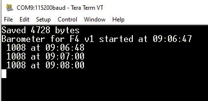

I can report you are indeed correct, I can access the BMP180 whilst still having the SYSTEM I2C setting.
Note that this was some old code written by AndrewG for the F4 (I didnt change the print string) but what I am happy about is that the BMP180 reads perfectly.
Thank you all for the quick response and leading me along the correct path.

Anyway here is the code I used

In my case (for my new board I am working on) we are using I2C2 on Pico Pins GP2 and GP3. It responds to RTC GETTIME with no issues either
