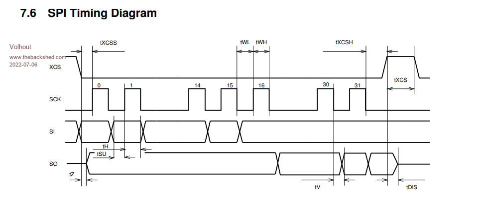

Posts: 8981
Posted: 07:54am 06 Jul 2022
VC1011e data sheet is Here - That's quite some chip!
I trust you aren't using VS1001 compatibility mode, Alan?
XDCS is SPI CS
SCK is clock
SI is connected to MOSI / SPI OUT on the PIC
SO is connected to MISO / SPI IN on the PIC
I suspect you might need to run SPI in Mode 1.
SPI frequency should not be higher than CLK1/7. Better a bit lower so probably no higher than about 3MHz as the minimum internal clock (CLK1) is 24MHz.

Posted: 09:07am 06 Jul 2022
Hi Guys
Thanks for the help - really appreciated.
Looks like the comments provided really helped me as i was able to initiate the sine wave test from the VS1011 module.
As suggested, i slowed the clock down, changed to mode 1 ie SPI OPEN 30000,1,8
Can probably go higher with clock, but this is fine for testing.
Once i did this, i could enter the data as hex or decimal and i was able to hear the sine wave. I was also also able to send the data in one lump, or line by line.
