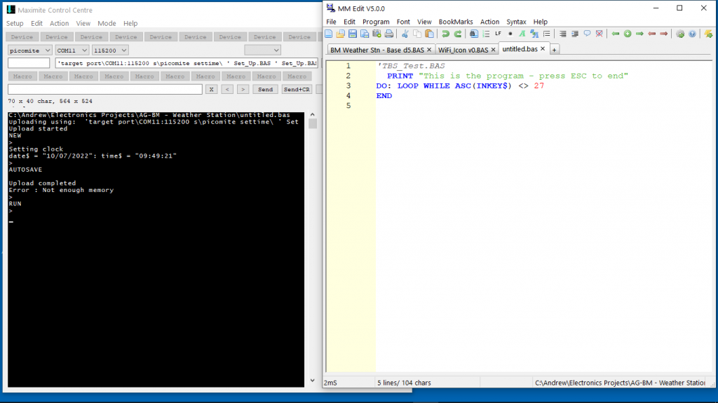

I've been happily writing/loading/correcting a program using MMEdit (v5) to a Pico (v.5.07.4). Its not large and has no big arrays - yet.
Then out of the blue, as I try to upload a program, I get the message:
AUTOSAVE
Upload completed
Error : Not enough memory”
MEMORY shows Program and RAM are 100% free.

Here is some simple code:
'TBS_Test.BAS
 Print "This is the program - press ESC to end"
Do: Loop While ASC(inkey$) <> 27
END
Here is the screen shot:
You'll see that is fails the load and has nothing to RUN.
LISTing reveals nothing has been saved (not surprising).
Cheers,

Maximite Control Centre
Build date: 2022/07/08
  Data server on port 50900 started
Control server on port 50899 started
started
C:\Users\Jim\Documents\apps\maximite\apps - Copy\untitled.bas
Uploading using:  'target port\COM4:115200 s\picomite
Upload started
Connected to COM4 at 115200
NEW
AUTOSAVE
Upload completed
Saved 131 bytes
RUN
I am not sure if your extra remarks after the settime is causing problems. I can't see how.

Posts: 6603
Posted: 06:33am 10 Jul 2022
Line 105 of MMCC.inf has a lot of extra text.
Delete everything after settime\ and see if that makes a difference.
I will have to work  out how that happened.
At a quick look, I can't see anything else that's a worry.
Posts: 6603
Posted: 06:37am 10 Jul 2022
Yes!
That was the problem.
Now to find out how it happened.
