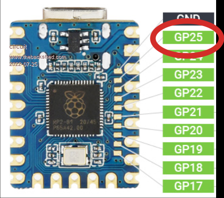

The Waveshare Pi Zero brings GP25 out to a solder pad and benefits from b15.

Posts: 8981
Posted: 06:06pm 24 Jul 2022
I'm not sure that I'd call bringing it out to a pad that only a technological flea with a magnifying glass could solder to is really "bringing it out". :)

  Mixtel90 said  I'm not sure that I'd call bringing it out to a pad that only a technological flea with a magnifying glass could solder to is really "bringing it out". :)
Having hand-soldered the 144 pins at 0.5mm pitch on a Micromite eXtreme (three times so far...five more still in the parts drawer) four 100pin Micromite Plus and other such chips, I can assure you that the pad on the Pi Zero is GIANT by my standards...

Posted: 09:49pm 24 Jul 2022
Judging by the pic I'd be lucky to *see* them, never mind solder them. :(
1.27mm is plenty small enough for me. I even struggle a bit at 0.1" sometimes now. :(

Posts: 10000
Posted: 05:51am 25 Jul 2022
I have some of those waveshare Pico modules, and thin wires under at LEAST a good magnifying light are a must.  I used my microscope, and that made soldering easy, really.  Flux the pads, tin them first, tin your wire ends, cut them very short, more flux, tiny bit of solder - done.
But I grant you, they are not that easy to do if you don't have a microscope or good illuminated magnifying glass thing.
You DO need to use very thin wires, so that you don't put stress on the tiny pads via thicker wires, which can lead to them lifting off the PCB - never a good thing....
I used thin self-fluxing enameled copper winding wire in my experiment with those pads, but you could probably get away with using those coloured "DuPont" leads if you cut off the connector at one end and solder them to the pads.  I would not go for anything any thicker though, or just bending the wires around could pull the pads off the PCB.
I went looking for pogo-pins small enough to touch on those pads, but the problem always was that the pad width meant that the pads would short-out on the one next to it, cos they are that close together.
I toyed with the idea of a pad on the top layer, and the next one has a pad on the bottom layer, but NOT as vias so to speak.  I think that would have worked, but it was starting to get complicated at that point, so I gave up!
Posts: 2981
Posted: 06:20am 25 Jul 2022
Hi Lads,
Could you not solder a 1.27mm Male header onto those pads?
It looks the correct spacing and with 10 of them they would help with holding each other fast onto the PCB? Even a small bit of epoxy if you were worried about rigidity?
Maybe nip the points off the bottom of each header pin so they sit more flat?
Just an idea.
