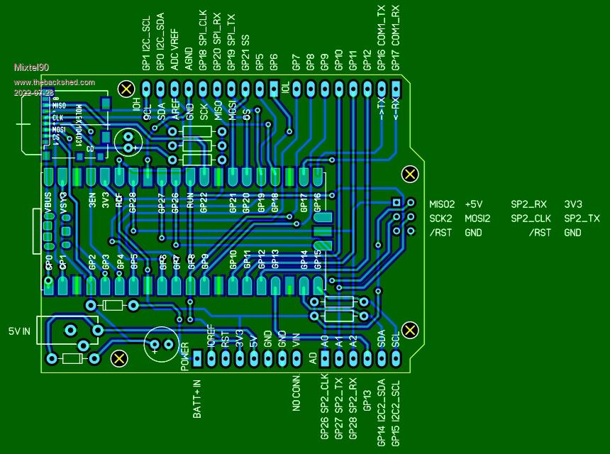

Sometimes there are daft ideas, other times there are dafter ideas. I think this may be one of the latter. It's for those who are homesick for the Arduino UNO.
Actually, it's probably a usable board as the fixing holes and IO connectors line up (even the misaligned one) and they all have signals on them that make some kind of sense, even though the PicoMite is lacking in the ADC department. This version has both I2C ports available and the ADC pins can be used for the second SPI, connected to the ICSP connector. The UNO never has a built in micro SD socket either. :)

Arduino layout / carrier board - and the Pico is to be soldered to it?
Posts: 8981
Posted: 06:30pm 27 Jul 2022
Yep, basically.
Some things just shouldn't be done really. I was bored. :)
The PicoMite has to surface mounted or you can't use shield boards with it. That's also why there's no RTC on board and why the micro SD socket is SMD.
Of course, you could just use a shield board and solder a PicoMie on, but custom boards are cheap from JLCPCB and you haven't got wire links all over the place.

I've changed it a bit:
Changed the barrel jack to a 2.1mm pin type
Added the 5V regulator
Rearranged the power chain and  so that it's like the Arduino now, accepting 7-12V input.
Added the TX / RX LEDs.
Added a solder blob link on the bottom for 3EN
Re-wrote the Arduino IDE in MMBasic.  (only joking)
EDIT:
Added a NPN transistor with base resistor from TP5 (the LED). Transistor is open collector, on spare pin 1 of POWER connector.
And now there's a Reset button and AGND can be isolated from GND.

Mick, this is a difficult adventure youre on. The main reason to do this would be the enormous amount of cheap shields that exist for the UNO.
These are in many cases very tightly coupled to the atmega328 funtions.
So you need spi at pins 11,12,13
You need pwm at pins 5,6,9,10
UART at D0 and D1
You need 6 analog inputs at A1..A5 that can also be used as digital inputs, where A4 and A5 also triple funtion as I2C.
And many shields need 5V or supply 5V logic signals.
I once rewired a MX170 on an arduino UNO and found little joy sine there where so many mismatches in either signal levels or functions.
Edited 2022-07-29 10:51 by Volhout

Posts: 8981
Posted: 06:34am 29 Jul 2022
TBH I never considered this to be viable. There's no point whatsoever in building it as the cost of the bits is more than a pre-built Arduino UNO clone, and with the clone you get full compatibility (probably). I'm not on a quest. It's not intended to be electronically compatible (it can't be anyway - not enough ADC pins). It was just a bit of fun when I got bored. :) It is not, and can never be, a drop-in replacement for an Arduino UNO. It's a PIcoMite that's mechanically compatible, that's all.
Shields are *supposed* to check IOREF to determine if they are on a 5V or 3.3V platform, as not all Arduino models are 5V compatible. In theory, plugging an Arduino shield into this won't cause damage, but it certainly won't work "out of the box" as MMBasic has no library support.
If you want to program an Arduino UNO R3 in BASIC then use GCBASIC. You get fully compatible hardware and a really good, free BASIC compiler. You still have no library support though. At the end of the day it's the massive number of easily installed libraries that make the Arduino family what it is. The hardware is pretty mediocre really.
EDIT:
I think there might be a release version at some point, however it won't be mechanically or signal compatible with the Arduino. Rectangular PCB (no silly shapes), all connectors on 0.1" centres and deliberately positioned to not allow Arduino shields to be fitted. It does make a nice little general purpose board though, that can be powered from 12V and output 5V and 3.3V supplies to external equipment. There's no reason why it couldn't have it's own shield system, all the supplies and signals are there. It might be slightly narrower too, at 50mm, to get two out of 100x100. I'll have to think that one out.
Edited 2022-07-29 17:45 by Mixtel90

Pin correlation:
(Tidied up a bit)
Arduino             ArdoMite
UNO R3
1  Blank            TP5 transistor collector
2  IOREF (3.3 or 5) 3V3             Input voltages shouldn't exceed this.
3  PC6 - Reset      RUN
4  +3V3             3V3
5  +5V              5V
6  GND              GND
7  GND              GND
8  VIN              VIN
9  PC0 - A0    GP26/ADC0
10 PC1 - A1         GP27/ADC1
11 PC2 - A2    GP28/ADC2
12 PC3 - A3    GP13              No A3 onPicoMite
13 PC4 - A4    GP14/I2C2_SDA     No A4 on PicoMite
14 PC5 - A5    GP15/I2C2_SCL     No A5 on PicoMite
15 PD0 - RX    GP17/COM1_RX
16 PD1 - TX    GP16/COM1_TX
17 PD2 - INT0       GP12
18 PD3 - INT1/PWM   GP11/PWM5B
19 PD4          GP10
20 PD5 - PWM        GP9/PWM4B
21 PD6 - PWM        GP8/PWM4A
22 PD7      GP7
23 PB0    GP6
24 PB1 - PWM        GP5/PWM3A
25 PB2 - SS/PWM     GP21/PWM2B
26 PB3 - MOSI/PWM   GP19/PWM1B/SPI_TX
27 PB4 - MISO       GP20/SPI_RX
28 PB5 - SCK        GP18/SPI_CLK
29 GND            GND
30 AREF            VREF            Not identical in function.
31 PC4 - SDA        GP0/I2C2_SDA
32 PC5 - SCL        GP1/I2C2_SCL
A3. A4 and A5 are not available.
All I/O is at 3V3, not 5V.
ICSP Connector
1 MISO2             GP28/SP2_RX     Also ADC2
2 5V                3V3             Not the same as Arduino
3 SCK2              GP26/SP2_CLK    Also ADC0
4 MOSI2             GP27/SP2_TX     Also ADC1
5 RESET2            RUN
6 GND               GND
Edited 2022-08-02 07:09 by Mixtel90

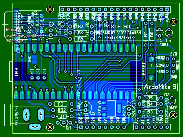

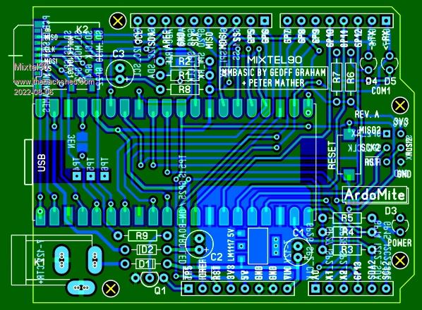

Here it is.
ArdoMite and ArdoMite_S
ArdoMite is a mechanical replacement for an Arduino UNO R3.
ArdoMite_S is the way they should have designed it, with everything on a 0.1" grid. :)
They are both the same electronically. The Construction pack includes the Gerbers for both versions.
Construction pack.zip
