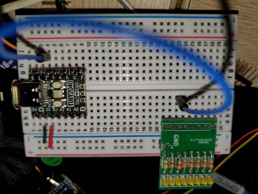

I've been playing around with using SETTICK to create essentially variable rate blinking by issuing successive SETTICK commands to change the "period" on-demand.
Now I believe that SETTICK PAUSE <target> ,1 and SETTICK RESUME <target>,1 are what I really want if I wish to HALT the blinking on an output pin.
But reading the manual, I saw that SETTICK 0,0,1 would disable the timer.  My observation, so far, shows me that *if* I issue that command "SETTICK 0,0,1", I actually don't seem to be able to re-enable it with a follow-up "SETTICK 1000,<target>,1  (where <target> is my interrupt subroutine, of course).
Am I doing it wrong if I thought "disabling" the tick timer means I can also "re-enable it later" by issuing a standard SETTICK command?  (Because in my test code... I could not re-enable it and I had to reboot to make it work again)

Works fine for me. Not sure why you think you need to use PAUSE and RESUME. They were for a very specific reason. Were you pausing and then issuing the SETTICK 0,0,1? If so you may need to resume after the new settick

SetTick 0,0,1
SetTick 2000,MYINT,1
That example is exactly what I was doing with Picomite... but my experience was that it would not restart.
Hmmm... I'll keep experimenting, I guess.

Confirmed to working now... I'm not sure why I was having a problem with it.

I developed/tested the example on the PicoMite V5.07.05b15

At this point,  I'm going to blame the pico hardware acting up as my code matched your example.  I'm running the same version of firmware  ;-P
