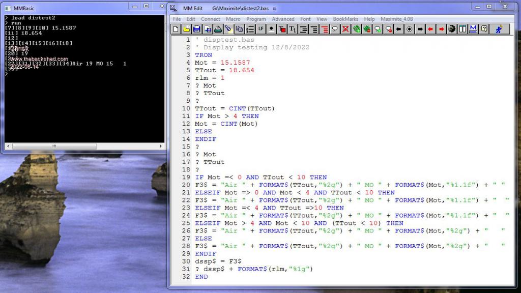

When using TRON within MMBasic the simulator on my windows machine, why don't the execution line numbers coincide with the lines of the program displayed by MM Edit.
Is it a version problem with MMBasic?
Here it is again with a image of the two windows.
Not sure how clear it will be.
MMBasic for windows shows a line 34 to execute the print. The file in MM Edit has an end statement at line 32 ??

The version of MMEdit you are using adds 4 lines of comment to the bas files.
Under Preferences, remove "save config in bas" and the number will line up.
Not a problem with MMEdit V5 or if you are sending files to an attached 'mite in which case, the config data is not sent.

When you save a file similar to this is inserted at the beginning:
'MMEDIT!!! Basic Version = Micromite_MK2_V5.2
'MMEDIT!!! Port = COM5:38400:10,300
'MMEDIT!!! Device = Micromite_MK2_V5.2
'MMEDIT!!! Config = 100111101121010110020000110001
If you  remove "save config in bas" from preferences, next time you save the file, the extra lines should not be added.
Not being able to use "run in dos" usually means that you don't have it pointing to the exe.
Try holding 'shift' when clicking and you should get the option to find the exe file.

Thankyou muchly    Jim
Tried that and it works.
Is this documented anywhere? I have been doing it the hard way for years.
This is so much simpler.
