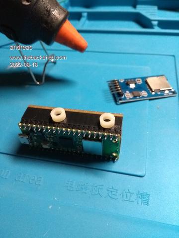

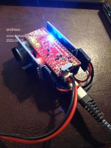

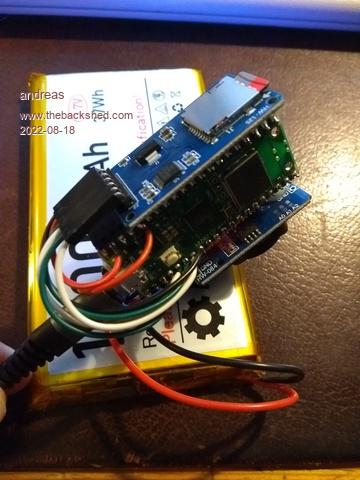

Hello,
today I took some parts: pico w, RTC module, SD-Card Module, DiP Pi Power Master, some distance holders, glue and created this mini computer.
It is certainly the smallest I ever made :-)

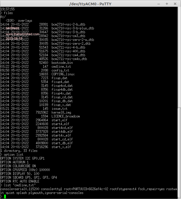

The "mini" can store data and programs on the SD-Card, It has date & time for logging measurements, it can be received by WLAN when using MicroPython, it has an UPS with 10000 mAh akku and a power management with DC input 6-18 volts and has a size of a matchbox.
I tested the SD-Card with an Raspberry Pi 4 Card and listed the files using Picomite "files"  and the "list" commands.

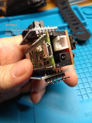

Posted: 05:58am 18 Aug 2022
After connecting the Dip-Pi Power Master, I used the first 7 Pins of the Pico W to connect the two external devices (SD-Card, RTC). They are listed as "free" or not used by the power master itself.
SD-Card on Pico (VSYS, GND)
Pin7 = GP5 = CS (SD-Card)
Pin4 = GP2 = CK (SD-Card)
Pin5 = GP3 = MOSI (SD-Card)
Pin6 = GP4 = MISO (SD-Card)
RTC on Pico   (3V3, GND)
Pin1 = GP0 = SDA (Clock)
Pin2 = GP1 = SCL (Clock)
OPTIONS
OPTION SYSTEM I2C GP0, GP1
OPTION AUTORUN 1
OPTION COLOURCODE ON
OPTION CPUSPEED (KHz) 100000
OPTION DISPLAY 50, 100
OPTION SDCARD GP5, GP2, GP3, GP4
-andreas

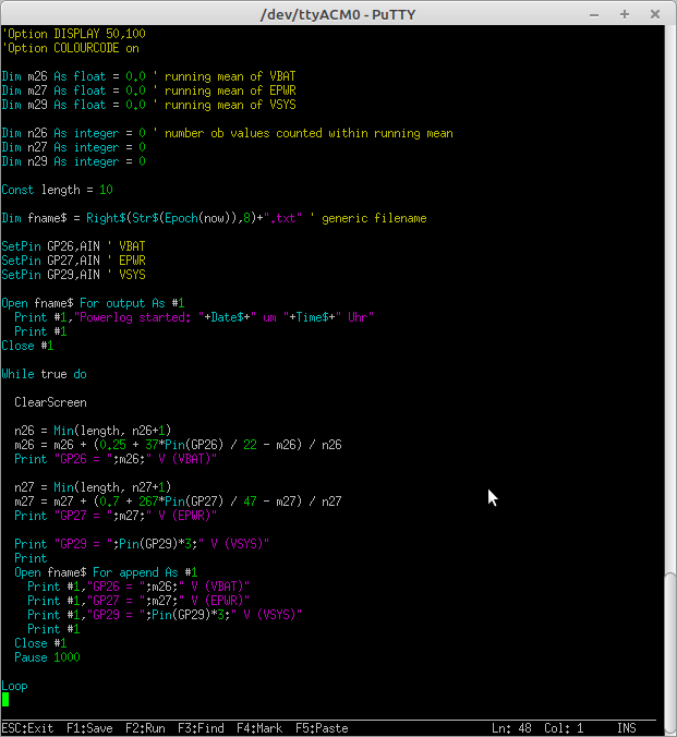

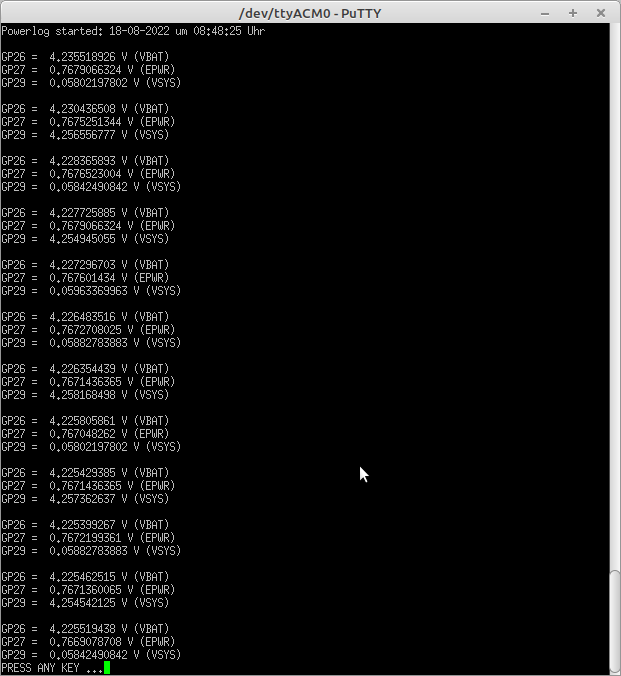

Here is a PicoMite program to test the "mini". It was run with only the akku connected. No external power source, no USB cable.
It logs: VBAT, EPWR and VSYS.
When connecting a solar panel EPWR will show somting like 16-19 volts and charging the battery. But this morning the 3.7V battery was charged fully to 4.22 volts.
The output of this program:
What I don't understand is the oscillating value of VSYS when using a pico w? Every second value shows VSYS the other value is near zero volts.
-andreas

Update with time&date logging:
'Option DISPLAY 50,100
'Option COLOURCODE on
Dim m26 As float = 0.0 ' running mean of VBAT
Dim m27 As float = 0.0 ' running mean of EPWR
Dim m29 As float = 0.0 ' running mean of VSYS
Dim n26 As integer = 0 ' number ob values counted within running mean
Dim n27 As integer = 0
Dim n29 As integer = 0
Const length = 10
Dim fname$ = Right$(Str$(Epoch(now)),8)+".txt" ' generic filename
SetPin GP26,AIN ' VBAT
SetPin GP27,AIN ' EPWR
SetPin GP29,AIN ' VSYS
Open fname$ For output As #1
 Print #1,"Powerlog started: "+Date$+" um "+Time$+" Uhr"
 Print #1
Close #1
While true do
 ClearScreen
 n26 = Min(length, n26+1)
 m26 = m26 + (0.25 + 37*Pin(GP26) / 22 - m26) / n26
 Print Date$+" "+Time$+" GP26 = ";m26;" V (VBAT)"
 n27 = Min(length, n27+1)
 m27 = m27 + (0.7 + 267*Pin(GP27) / 47 - m27) / n27
 Print Date$+" "+Time$+" GP27 = ";m27;" V (EPWR)"
 Print Date$+" "+Time$+" GP29 = ";Pin(GP29)*3;" V (VSYS)"
 Print
 Open fname$ For append As #1
   Print #1,Date$+" "+Time$+" GP26 = ";m26;" V (VBAT)"
   Print #1,Date$+" "+Time$+" GP27 = ";m27;" V (EPWR)"
   Print #1,Date$+" "+Time$+" GP29 = ";Pin(GP29)*3;" V (VSYS)"
   Print #1
 Close #1
 Pause 1000

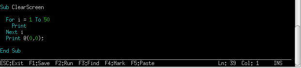

Sub ClearScreen
 For i = 1 To 50
   Print
 Next i
 Print @(0,0);
End Sub
-andreas
Posts: 11854
Posted: 07:50am 18 Aug 2022
  Quote  What I don't understand is the oscillating value of VSYS when using a pico w
GP29 is connected to the wifi chip and used as the CLK pin
andreas
Joined: 07/12/2020
Posts: 226
Posted: 09:09am 19 Aug 2022
many thanks for this info!
