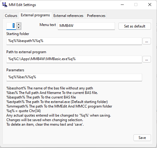

Only just got around to installing it but how to actually get code in to it?
I have only ever used MMEdit on the MCUs.

  Tinine said  Only just got around to installing it but how to actually get code in to it?
Quite normal with Load "program.bas"

MMEdit5
 Action/Edit list
 Change the spin-box up to the next available spot That will be '1' if you haven't added any other external programs.
 Menu text = MMB4W
 Starting folder = %q%%baspath%%q%
 Path to external program = %q%C:\Apps\MMB4W\MMBasic.exe%q%
 You will have to edit the path to point to your MMBasic.exe location
 Parameters = %q%%bas%%q%
 You might as well click on "set as default" so the run in DOS button changes to MMB4W

Working beautifully
Many thanks, Jim.
