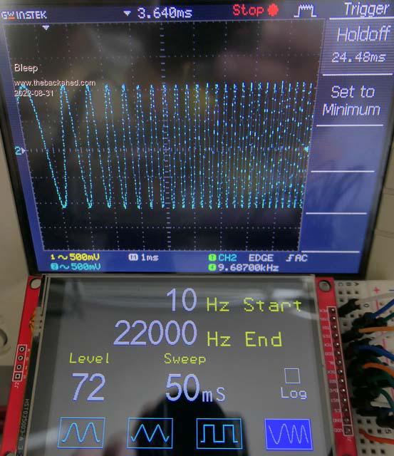

I have re-worked some work done by Peter & Geoff from a few years ago.
How to drive the AD9833 is a DDS function generator
Geoff's DDS Signal Generator

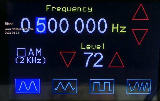

The main differences are that I am driving a 480x360 LCD touch screen (simply because I already had several I got cheap) so I had to re-size everything to make it look nice, I made the touch points larger than the buttons/display areas to make finger operation easier; I also had to change the way touch points were being handled, as they were using some form of interupt that isn't now required/supported on the PicoMite. I also found that for some reason, my setup, would only work when the SPI mode was 3, where as Peter originally used mode 2? Because the PicoMite has 2 SPI busses, I was able to get rid of a lot of SPI opening and closing as well :-)

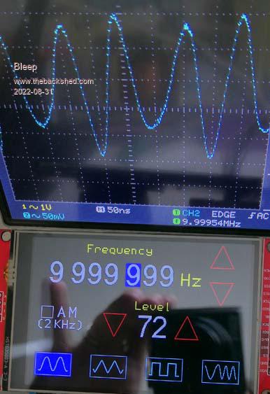

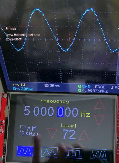

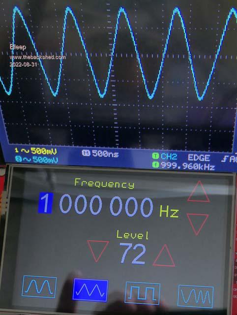

The wave forms it will produce, Sine, Triangle, Square, are very good up to at least 500KHz, after that the Triangle gets a bit rounded top & bottom,
and the square goes a bit pear shape on the falling edge,
the sine is fairly good to 1MHz, above that it starts to get a bit squigly (technical term) probably because the DDS module only has a 25MHz clock, so at 5MHz sine wave output there are only 5 reference points to generate the sine and by the time you get to 10MHz there are only 2.5 sample point.
I attach my version of the MMBasic PicoMite code for your delectation.

Could the issues you see on the waveforms be to do with a little bit of natural capacitance in your breadboard-type connections at those frequencies?
It might behave better on a PCB layout with a good ground-plane.
Perhaps.
In any event, this is stellar work.
Posts: 5999
Posted: 06:57am 31 Aug 2022
Hi,
The distortion you see is most likely in the amplifier (or digital potmeter if that is used), not in the AD9833 itself. It should give a nice square wave and sine wave at 1MHz.
Bleep
Joined: 09/01/2022
Posts: 820
Posted: 07:52am 31 Aug 2022
I have tried looking at the square wave signal direct, before the op-amp and it's the same, is it possible to look at it b4 the attenuator? I suspect that it's the usual cheap Chinese reject chip!
