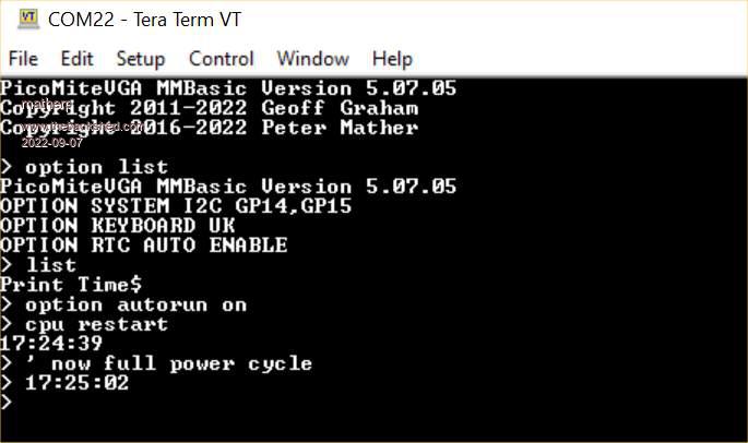

I'm having a weird issue.
Using an RTC, Waveshare PICO 3.5 display and Pico Lipo... if I remove the USB POWER and then restore it... my Pico display shows incorrect time... relying on Autorun to start up... if I use a terminal program and disconnect then reconnect, hit CTRL-C to get ">" prompt and type "RUN", it works as expected.
Granted... the RTC is using UTC time and I do a timezone conversion... but why would it work with manual "RUN" and fail to work with "OPTION AUTORUN ON"?  (I assumed they did the same thing)

Works for me
You don't say what the "incorrect" time says

Well, an explanation of my 400 lines of code might have been in order to fully understand... but, because of that many lines... fine details were avoided.
The gist of what is going on is that the RTC is set to UTC and I have a routine to deal with adjusting for timezone and a routine that figures out if DST is in place or not. (To adjust the time by an additional hour or not).
When I ctrl-c and type RUN... it works as expected... but from a cold boot, it seems to want to subtract the additional hour from the timezone and an additional minute. Technically, the cold boot and warm restart should be doing the same thing.
I do have some debug data output to the screen, but I can only see it AFTER I perform a CTRL-C and "RUN" but that's when it starts working right.  I don't have a way to capture USB Serial on a cold start because the virtual serial port won't be connected yet.
I'll see if I can find a way to share code without cluttering up this screen.

Posts: 11852
Posted: 06:28pm 06 Sep 2022
It is a bug in your code. You are calling GETDST before RTC GETIME. Swap lines 206 and 207 in the code you PM'd. Works after ctrl-C because the time/date is already set.

Posted: 07:23pm 06 Sep 2022
Man... you can become so blind to your own code sometimes. Thanks
