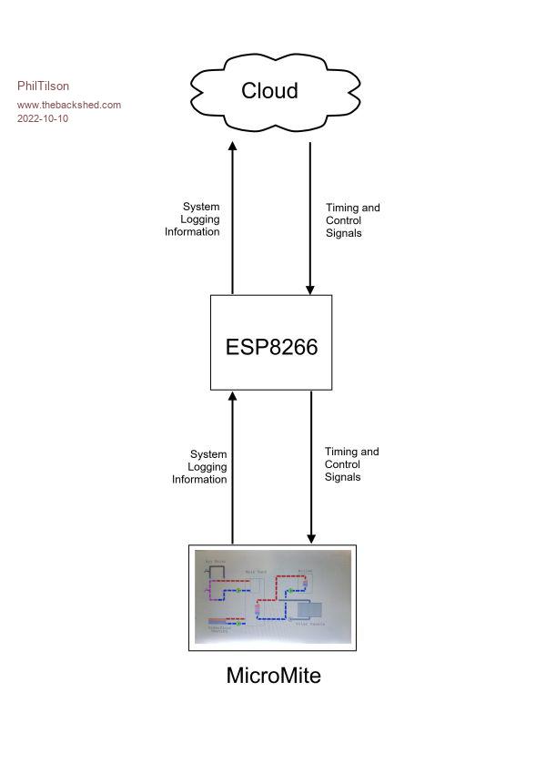

I am stuck with a problem which is defying all my attempts at solution.  It's a little complicated, so really aimed at people who like to get inside a problem creatively!
I have a heating control system that comprises a MicroMite Plus as the main processor and an ESP8266 as a link to the internet.  The main processor does all the clever stuff, monitoring temperatures, determining when various valves and pumps should operate etc and the ESP keeps the RTC accurate by using internet time and sends log entries to a MySQL database on my ISP's server.  It also acts as a web server, enabling control of the system from anywhere over the internet.  This is summarised in the diagram.
Both parts of the system are working perfectly!  So, what's the problem?
The system is based in Spain where the mains supply can be a little erratic at times.  Although there is a backup battery, once in a blue moon, the main processor 'hangs'.  I can tell when this occurs as the time on the web page freezes (the ESP keeps working fine).
So I wanted to devise a means of resetting the MicroMite remotely.  I added a button to the web page to allow for a System Reset and when this is 'received' by the ESP, it pulls an IO pin to ground for 500mS.  Then I had to work out how to get that signal to the MicroMite over the ribbon cable.  I decided to use pin 70 on the Micromite as this is brought out on the 40-pin connector and wasn't being used for anything else.  This pin I linked directly to the 'hot' side of the reset button, so that when the ESP pulls its pin low, the MicroMite resets.

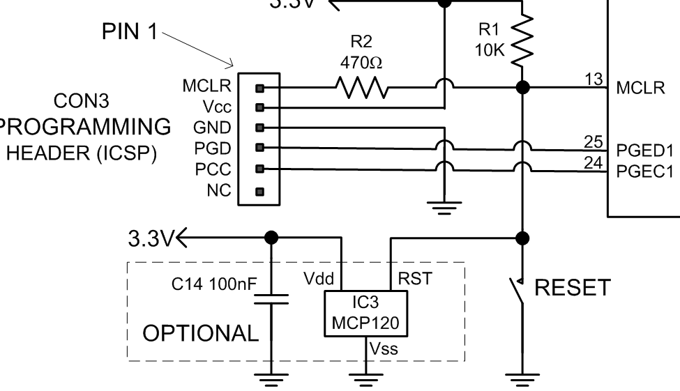

Posts: 6603
Posted: 08:05pm 09 Oct 2022
If it is the explore 100 version, pin 70 is SPI so shouldn't be connected to reset.
Connect to the reset alone and leave pin 70 free to do it's own thing...
The explore 100 has an optional reset circuit included to cater for slow power supply rise time and brownouts.
If your system doesn't' have that addition, now is the time to fit it.
As a final protection, once the external issues have been fixed, use a watchdog in your program, but fix the problem first, or at least, record when the watchdog is activated.

Mixtel90/Volhout/JohnS/TassyJim: On this chip, pin 70 is just an IO pin.  Yes, it is also used for other functions but, until specifically programmed for those functions, it's just an uncommitted pin.  However, In an attempt to solve the problem, I physically disconnected the pin (by cutting the trace) from the 40-pin connector I was using to link the two processors, and it made no difference, so I have concluded that this was probably not the problem.
CaptainBoing: Absolutely accept the need for good decoupling and have implemented same.  I have also set the Watchdog timer, and at somewhat of a loss to explain why this does not reset the processor when it 'stops'.  I can only conclude that the glitch, whatever it is (it only happens about once every couple of months) is sufficient to stop the processor completely so that it cannot reboot itself (not exactly sure how this aspect works!).
TassyJim: Yes, I have the brownout/PSU MCP120 installed.  However, see next point...
led-bloon: The system is powered from a LiPo battery which is float-charged continuously from a plug-in PSU, via a LiPo charging regulator circuit.  The battery lifetime when the system is idling is several hours, and although power outages of 12 hours are not unknown in this part of Spain(!) I don't think this is a likely cause of the problem.
Since posting the original query, I resorted to a direct connection between the ESP and the reset button via a separate wire.  The problem continued!  Unfortunately, I don't have my test equipment over here, but I am wondering if there is some strange 'race' effect going on where the application of the power is starting up the ESP fractionally after the MicroMite which is therefore being reset, which is resetting the ESP etc.  Sounds odd, but without a scope, I can't check for things like that.  I will be taking a parallel system back to UK with me in a week or two and will carry out some more tests - and report my findings!
Finally, I have circumvented the problem in a rather crude, but effective way!  I now have a small pushbutton on the box.  If I want to power-up from scratch, I hold the button in to disconnect the reset wire while I switch on, then release it, and all is well, and I can reset the MicroMite remotely.  It wont solve the problem of the battery running out, though!

Nimue: Oh no, it's a lot more complicated than that!  There's a set of solar tubes that need to be monitored for circulation, a gas-fired boiler to add heat when necessary, two 'ring mains' for hot water which need to be separately controlled at different times of day and an underfloor heating sysytem to be monitored!
CaptainBoing: Nothing on PGD and PGC.  Weird poblem  but now solved, albeit rather clumsily!
