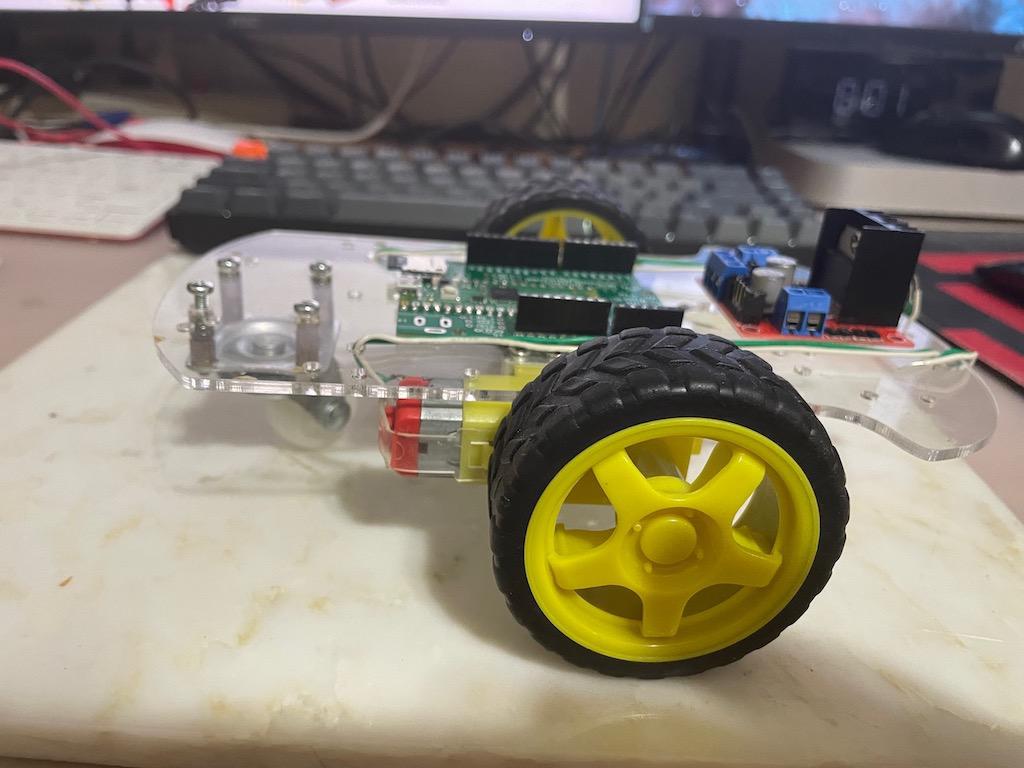

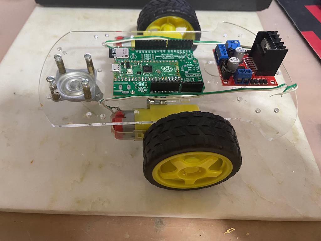

Mixtel90 Mick though pure Genius, rarely seen independently had the thought of a Picomite to replace the Arduino, and I instantly jumped all over it due to all the Arduino kits I've collected over the years and my lack of C programming ability like the ubiquitous robot 3 wheel cars. My Serious First thought Instantly was to use them in Robot Sumo, and I showed them to my robot friends, and we are working on a PicoMie spec Robot Sumo class that would require one of the 2 ArdoMite controllers and a 3 wheel robot car kit base, basically a class anyone could afford a sub $20- $30  robot and runs off basic so an 11 or 12 year old kid could take the sample code and learn! NO C!!!! The Picture Below is just a Quick Mock up for illustration
Rick

That's very nice, Rick. I shall watch this with interest. :)
