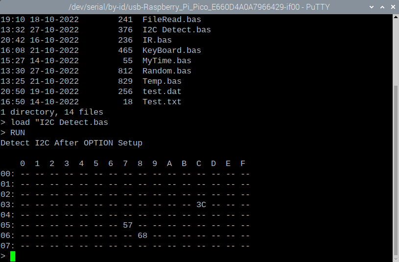

When I write
Text 1,1, "Testing 12345" or any other place, I got only upper half of Testing message.
I am wondering if I am missing something.
I try to find I2C address and got 0x3c, but I can't put it any were.
Do anybody has a similar problem?

I have an RTC on the same I2C bus as the SSD1306 and I used option rtc auto enable to have the date and time read when the PICO starts. My assumption is that it knows the address because of that.
The clock is at H68, Memory at H57 and Display at H3C. The only thing I have to address in a program is the Flash Memory. The rest just works.

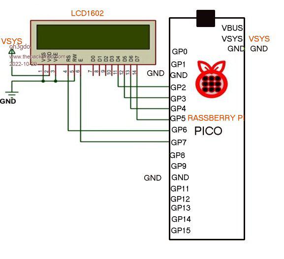

Thank you again. but I cant find GP23 or GP GP24 like in the manual.
I took GP6 (En) and GP7 (RS) like in the picture.
I think this doesn't matter.

All ports on the PicoMite are 3V3 - but as outputs from the Pico that's almost always fine for 5V stuff as it's within 5V TTL tolerance. However, you can't connect 5V TTL signals directly back to the PicoMite as you'll damage the inputs. There are ways round this though. In this application RW is grounded so you can't read 5V signals back on the data lines.
The Data lines D0-D7, EN and RS are all outputs from the PicoMite (unless you are reading data back from the display - not a common thing to do) so should (in theory anyway) drive most common HD44780-compatible LCD displays. Note that the LCD power might still have to be at 5V though.
You can use any of the PicoMite pins, but you must specify them all as DOUT using SETPIN first and then specify them in the BITBANG LCD INIT command. You only need to do these steps once so there's no need to have them in a SUB.

VEE should be connected to a potentiometer between VSS and VCC. The display may be working but you aren't seeing anything because the contrast is zero

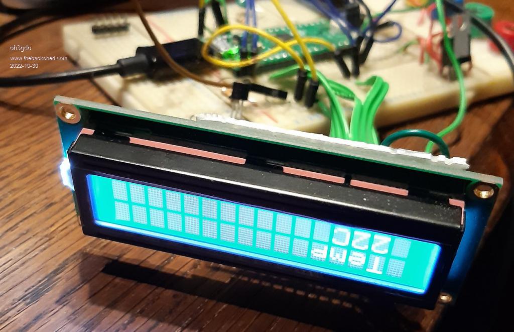

Now I found my problem with my LCD 1602.
I was started to put LCD pins from pin 5, although it was should start from pin 4.
In the pictures was missing gnd pins, although it should not happend.
Thank you who will help me.

matherp is right - if you put a potentiometer of around 1k-5k between GND and 5V with its slider connected to VEE then you can adjust the contrast. Those character positions that you can see can be faded out almost to the point where they can't be seen. start with the slider at mid way and "tune" it to taste.

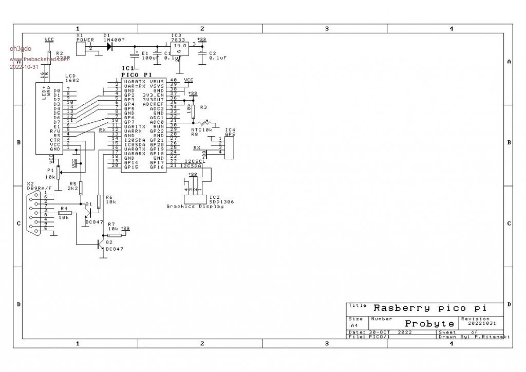

I did my first PCB today.
Here is schematic
I is nothing to work, but I am sure that when can handle PICO more, it will find some work.
