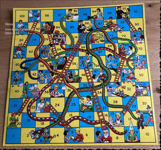

I use this board:
Recently a student offered this:

I find it interesting that (a) many students have never played Snakes and Ladders and (b) As a kid myself, I never realised there was 0% input from the player other than to roll the dice.

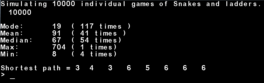

Full version - with all feedback greatly received:

Posts: 6105
Posted: 07:51pm 01 Nov 2022
Statistics is a nice thing....
But sometimes not very logical.
Your screendump is probably not from board #1.
The sequence 6,6,1 is the shortest route on board #1.
The probability of throwing 6,6,1 as first 3 rolls is 1/216.
Therefore I would expect the shortest route (6,6,1) to be rolled 50 times (10000/216)
And if unucky, maybe 20 times, or 10 times.
But apparently your run of 10,000 did not have a singe 6,6,1 roll....
Even if you start OFF the board (square 0) the shortest route (4 length) is:
1,6,6,1
2,5,6,1
3,4,6,1
4,3,6,1
5 not, since you ladder up
6,1,6,1
This still have a probability of 1/259, so you would expect the shortest route to be present in 10,000 runs.

Stats all workout if you use the original board data statements and change the line 'for y = 1 to 13' to 'for y=1 to 18' to correctly read the snakes and ladders positions. Run the simulation over 1,000,000 times (yes, I have little to do these days!) gives me these results:
Off board starting position gives minimum rolls of 4 in 3856 games - or 1:259
On board starting position gives minimum rolls of 3 in 4562 games - or 1:219
Both within acceptable tolerance as correctly calculated by Volhout.
One curiosity - the longest game I saw had 788 rolls! That explains the poor kid who never seemed to win a game.
