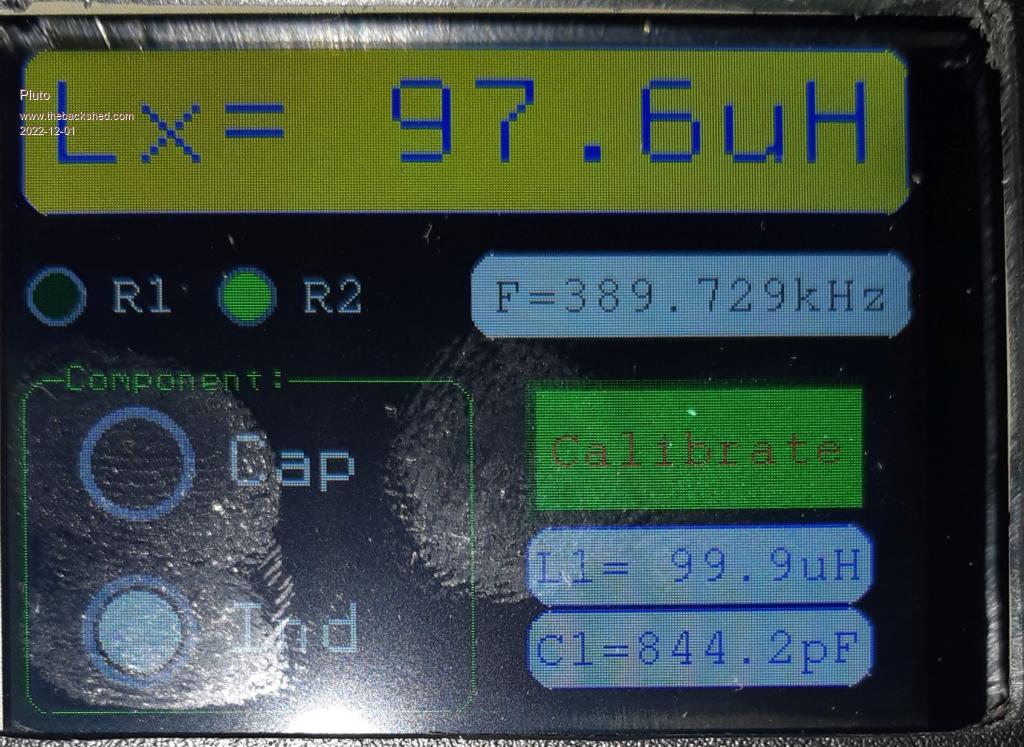

I have just completed a small project. It is a inductance and capacitance meter based on a PicoMite. It seems to work quite well:
-Capacitors down to a few pF and up to a few hundred nF. A normal multimeter can anyhow handle the higher values.
-Inductors down to below 1uH and up to at least 6mH (highest in the L box).

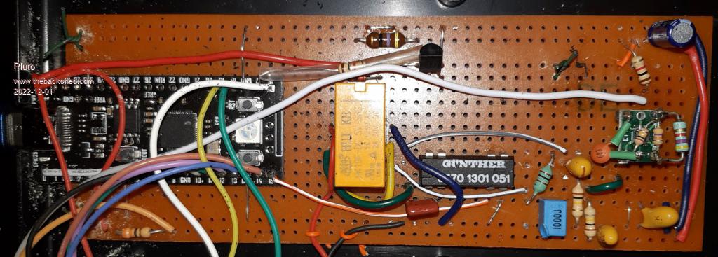

Quick and dirty build on a prototyping board. The comparator had to be put on an adapter (SOT-23 size).

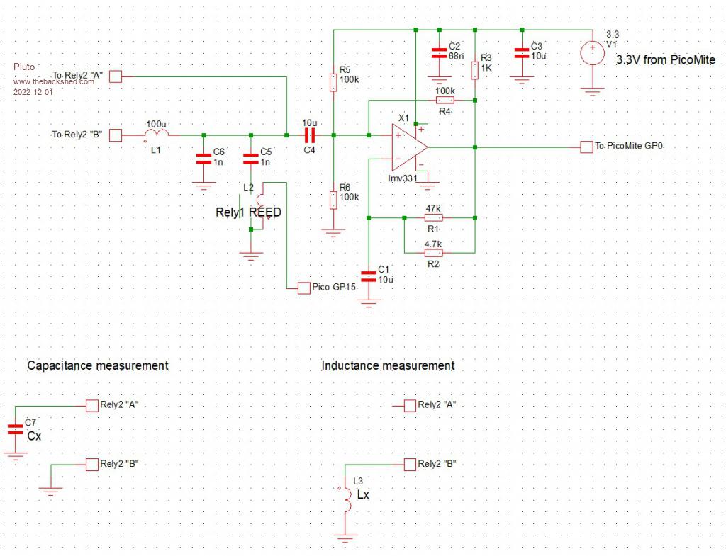

Hi Pluto,
Nice project !!!
Can you shart a circuit diagram ?

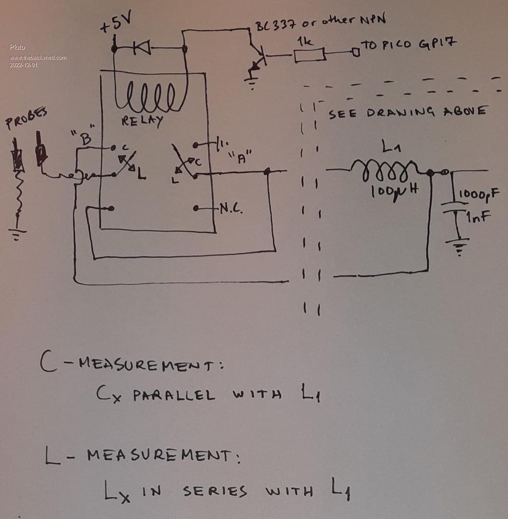

The front-end (selection of either L or C measurement) was too difficult to draw with the SIMetrix software, so I had to draw that by hand.
Depending on the relay configuration you have to carefully check before you start wireing. I didn't and I spent a long time trying to figure out why not working. On my particular rely the common pin was not between the NC and NO pins!

Hi Pluto,
Nice, you are building an oscillator (LC) around an opamp (LMV331) and and parallel/serial place inductors and capacitors under test.
Very basic, smart. You can of coarse extend the range by having an additional relay replace the 100uH with 10mH. Maybe have to adapt C1 and C4.
Thanks for sharing....

LMV331 is actually a comparator.
Compared to other capacitance/inductance meters that I have bought/built, this one gives more reliable results for the very lowest L and C values.
I decided to have separate calibration routines for L and C. There is a small difference due to the different signal routings when the 5V relay is on or off.
Once the calibration is done for each L and C the values are saved and ready at start up of the meter. Recalibration might be required when measuring L below 5uH or C below 5pF as there is some small drift (~100nH) when the meater is "warming" up.
