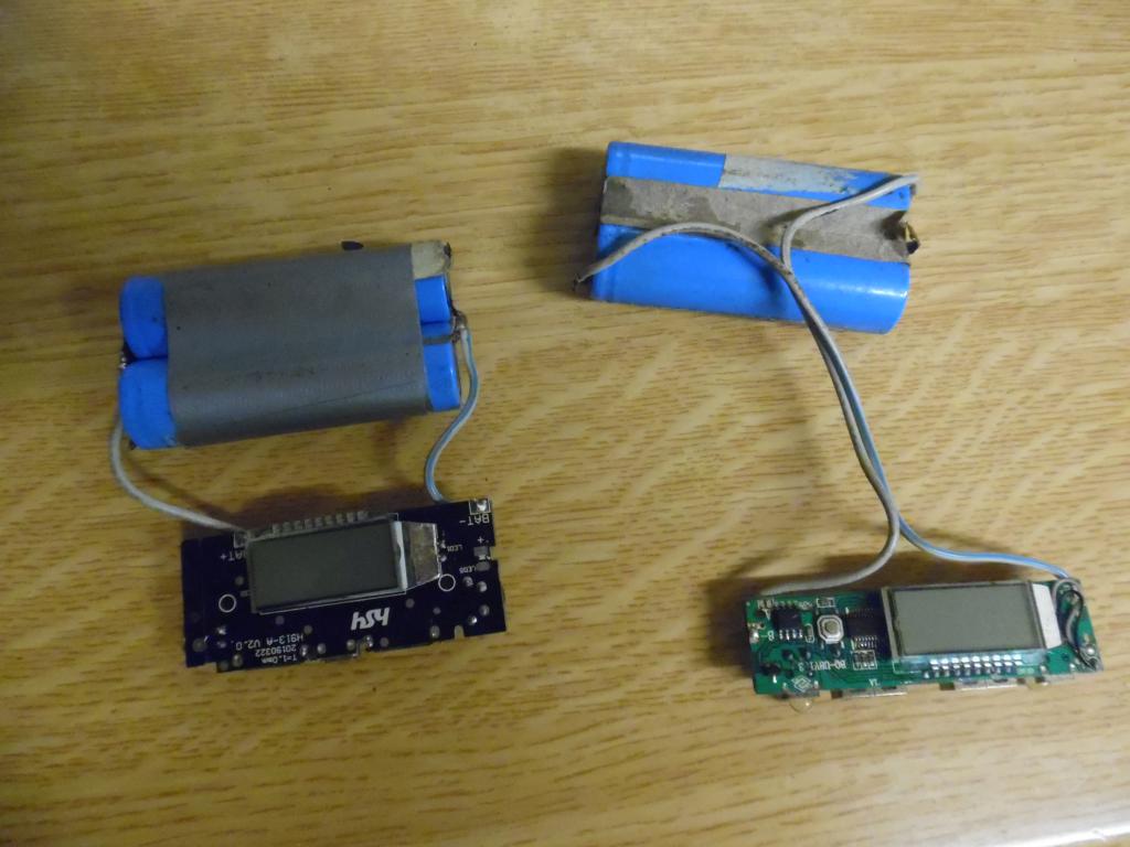

These are cheap. 1A and 2A usb out. Mini usb to charge and a lcd battery level
