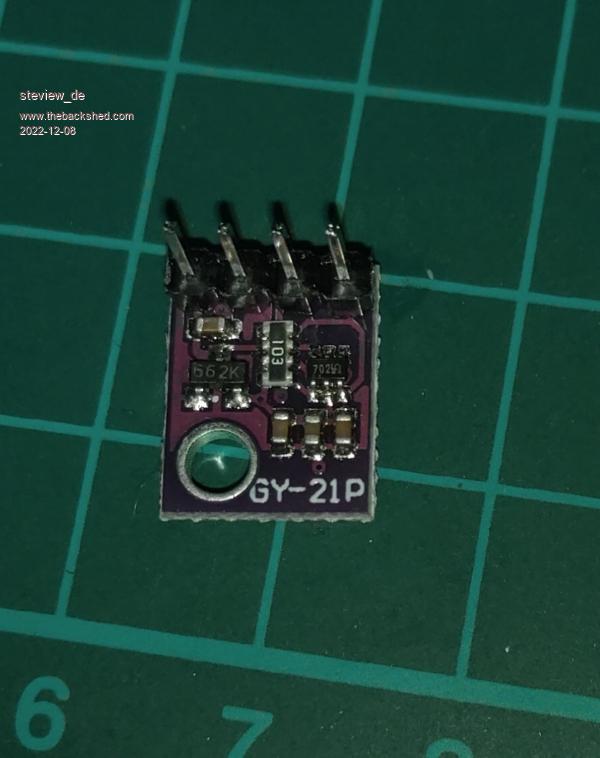

I added another slave to the I2C bus. A Temperature/Humidity Sensor, called "GP-21P".
I have it in my box from other µC projects.
2 Problems with it:
I don't have the adress and i don't know how to get any data out of it.
So, is there a command to "scan" and show the participants on the I2C bus?
And second: How do i get know wich data i have to read to get temp and/or humidity?
Thanks for help in advance.

Could be this one. Unfortunately you did not show the other side of the board.
Atmospheric Humidity Temperature Sensor Breakout Barometric Pressure BMP280 SI7021 for Arduino GY-21P By DIY
Found on AliExpress.
Seems to be 2 sensors on the board:
Si7021 humidity sensor I2C address 0x40
BMP280 temp and pressure sensor I2C address 0x76 or 0x77
Try with these and see if you get any response.

@Pluto, you seem fully right.
(Unfortunately the upload is not working at the moment :-/  )
On my output of the code from the link i found 6 adresses.
I use the command: I2C READ &Hxx, 0, 2, RData() (from p. 139 of the manual)
00 => with the "print" command i have only "0" on the "output"
3C => Print RData(0) => 1 / Print RData(1) => 1
40 => with the "print" command i have only "0" on the "output"
50 => Print RData(0) => 255 / Print RData(1) => 255
68 => Print RData(0) => 33 / Print RData(1) => 4
  a bit later: => Print RData(0) => 7 / Print RData(1) => 18
  a bit later: => Print RData(0) => 34 / Print RData(1) => 0
76 => with the "print" command i have only "0" on the "output"
On my bus there are:
- RealtimeClock
- SSD1306 OLED
- GY-21P
"Stevie"
