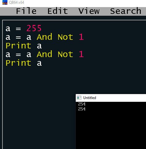

Having a senior moment.
Regardless of the current bit state
a=a or 1
Will set the bit but what's the short version of:
if a and 1 then a=a xor 1
Pretty sure that in other dialects it's:
a=a and not 1

Example: I am expecting a=254
a=255
a=a and not 1 'just want to reset b0
print a
The result is zero

a=a and INV 1

That's QB64
@matherp: That works! Cheers
Not in my DOS version though but it's not the latest.

I implemented INV in the CMM2 and have added it to most of my ports. It is the exact equivalent of the C ~ operator which is the standard way of clearing bits
To set bit n assuming numbering from 0
a |= (1<<n)
to clear bit n
a &= ~(1<<n)
