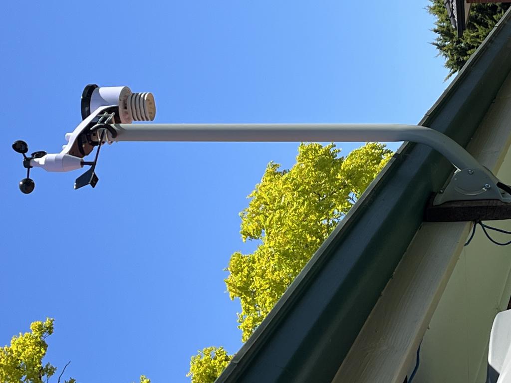

Hi All,
I have been working on a weather station project (Yes I know this topic has been broached many times before)
And I have 3 sensors that will measure Temperature
BMP180 +- 2 degrees C (or 1 degree depending on who you believe)
DHT22 +- 0.5 degrees C
DS18B20 +- 0.5 degrees C
Now I have regular reports, via an HC-12, from my remote unit (up the pole) and I thought that it would be a good idea to simply average these 3 sensors.
It is probably pedantic but I am ALWAYS seeing the BMP180 with the highest read, the DS18B20 with the mid range and the DHT22 with the lowest read.
Typical readings are (like this current one)
BMP180.    26.1
DS18B20.  25.25
DHT22.      25.1
From the vast experience of members who have been this path before Do you think I should discard the average and only use the DS18B20 as this is designed as a temperature sensor where as the other 2 are primarily for Pressure (BMP180) and Humidity (DHT22).?
The DHT22 is often lower than the DS18B20 by 0.25-0.5 degrees C. This current reading is closer than the norm.
The DS18B20 I chose was a genuine part bought from MOUSER so I feel that using it ONLY would be fairly accurate to within its rated accuracy. The BMP180 being almost always nearly a degree higher than the DS18B20 does tend to skew them average calculations a bit.
Anyway what are your opinions.?

I have seen similar variations.
Some can be due to self heating depending on layout of the sensors.
I have to make a similar decision for my WX station. I expect that the DS18B20 will end up winning.
The location and construction of the weather instrument enclosure will be the biggest determining factor for accuracy.

Whilst it is 'up the pole' it is not difficult to bring it down again, The pole I purchased is a very nice unit that can rotate down 90 degrees to make the unit accessible with a small step (see attached)
All 3 sensors are within 10mm of each other and are located in the `bee hive' section under the rain collector in the above picture.

I don't know why the image is rotated but You can make out what I mean about the pivoting pole.

What bothers me is that in the Australian summer, that "bee hive" will heat up to who knows what? and as noted by Jim you will get some pretty funny results.
I found the best place was under a rainwater tank mounted a couple of feet above ground and protected from direct sun light but open to air movement. I could then get believable results using a 18B20.
Good luck

I was wondering how things would be on the 45 degree C days and also how the plastic shell, especially being majority of White, would handle the sun.
Whilst the bee hive is no where near as good as the stevensons screen Jim mentioned , the way it is designed gives a reasonable amount of protection due to the overlapping effect of each shell.
My water tank sits on a concrete slab so unless I bury the sensors there is no going there.
I also doubt that it is a great place for a temperature sensor due to the mass of water that will tend to impede the temperature due to its large mass of water..  Maybe the bee hive mounted under the eaves would be a better solution for them.
At this stage the unit is just in the trialling stage as AndrewG is writing the proper code for it.
I am mainly trying to calibrate wind speed (against the Bureau of Meteorology) and rain fall (against my standard tube gauges). If all goes well I will have to pull it down so I can conformally coat the PCB and put dielectric grease around possible areas of water ingress. I have also thought of conformally spraying the outside of the unit but I would have to avoid the anemometer cups and the weather vane as I don’t want to impede their actions. Similarly the rain water funnel so it would only be the white areas.
