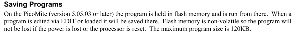

What is the size of the Picomite/VGA flash slots? I cannot seem to find that information in the manuals.

120K? Just type memory at the command prompt.

Would this mean that the Picomite VGA, for example, could actually store a program of 8 x 120KB, if I broke down the program into 8 different modules, for a total size of 960 KB, or maybe even 1080KB adding the program storage are which is not a flash slot?

I Understand that I can use FLASH CHAIN.
The manual states that the maximum program size is 120KB.
I take it to mean that this does NOT include the flash slots.
Is each flash slot also 120KB in size?

Earlier manuals say 124KB for flash slot & for program. I think both changed to 120KB.
(If the FLASH slot was bigger than the program size the extra would never get used, and if smaller you couldn't save a max-sized program...)
