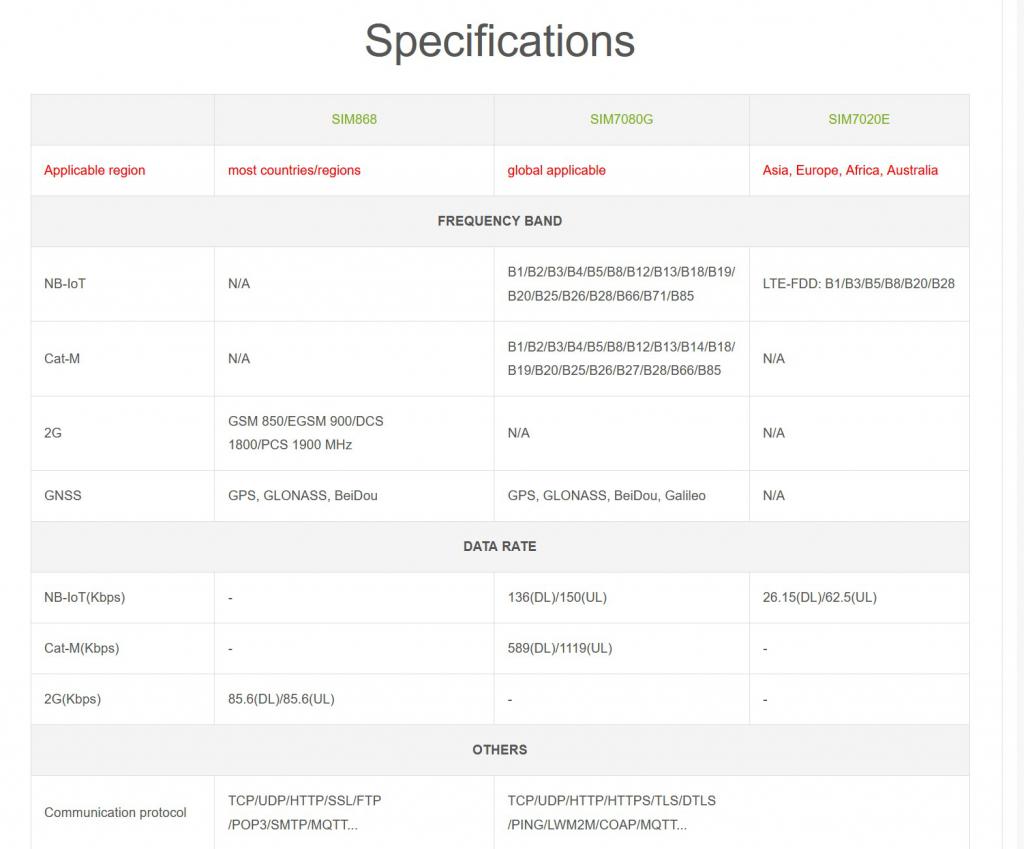

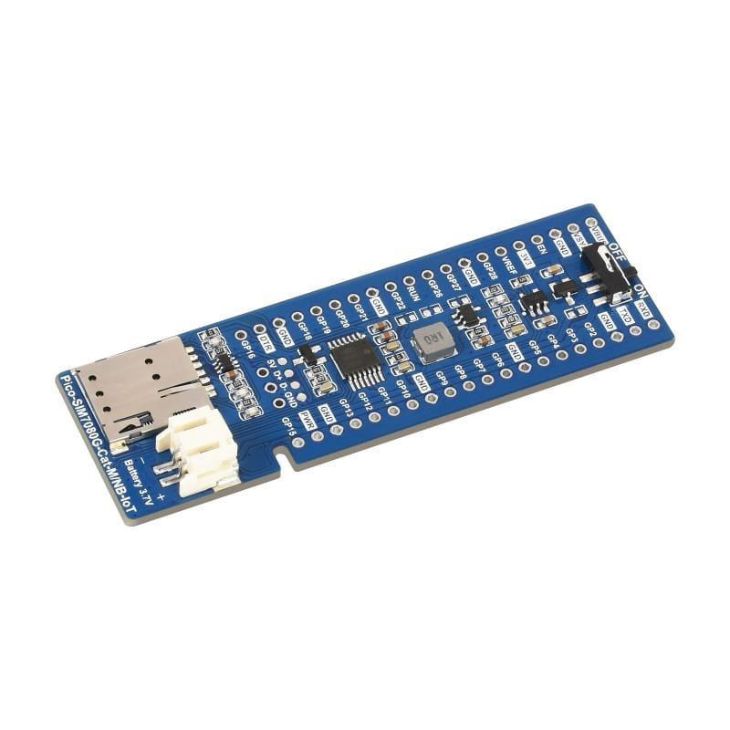

That using one of these inserting a 4G sim card that works all I would have to do is send and recieve AT commands to get web pages or send web pages using HTTP GET and HTTP POST?
Is it really that simple?
and I could send the gps location data using the same commands?
it's probably not that simple, I guess it couldn't be, but it would be nice it it was, you could put sensors anywhere and use the pico and 4G to get the data

  Tinine said  2G SIM but that's all I can contribute
Where did you get 2G sim from?
it's 4G LTE

I think the answer (for 4G in the UK) may be B20 (800MHz) & B3 (1800MHz). If so, the OP is OK.
I've used here
There are more, but I didn't want to get into FDD, TDD etc.
I posted the other board/chip version as it has LTE (and is sold in the UK).

I actually meant communication over the phone network using the sim
I know it's 4G because the UK uses mostly B1, B3 and B20
and it's an LTE device
I meant talking to it, is it as simple as using http get and http post using the uart port GP0, GP1 and GP17 to wake the module and GP14 to shut down the module

What i was trying to say is rather than going out and buying a random device ie
the one listed at the start of the post
https://www.waveshare.com/product/raspberry-pi/boards-kits/raspberry-pi-pico-cat/pico-sim7080g-cat-m-nb-iot.htm
do a bit of research on what is known to work with your phone company / sim provider
I found it a lot easier to start with the phone company / sim provider ie
https://www.telstra.com.au/business-enterprise/products/internet-of-things
https://www.telstra.com.au/small-business/internet-of-things/data-sim-plans
That way you can get the correct sim for your application ie lpwan or a standard iot plan
then choose the device " 4g/5g modem" that supports the network that you wish to connect to at the data rate your application needs
On the device " 4g modem" listed above it lists its sim card slot as only supporting
a NB-IoT / Cat-M card (1.8V ONLY)
hope that helps
and yes it is a bit more complicated than just stuffing your mobile phone card into it
but with plans starting at $1 a month it can be a very cheep way to get things communicating with each other

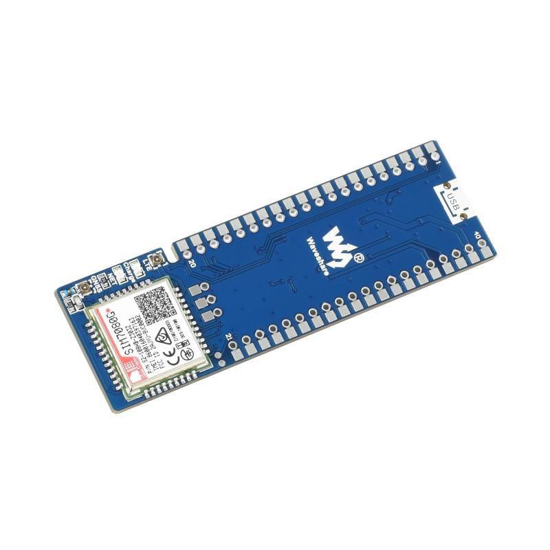

Actually, choosing a SIMCOM module that will work on your country's cellphone network can be something of a technical nightmare.  At least it USED to be, but now, basically from 4G LTE onwards, the entire planet seems to have standardized cellphone bands and frequencies, which makes modules that work anywhere much more easily producible.
Prior to that, 2G and 3G could be on any one of a plethora of frequencies, depending on what that specific country decided to assign it's network to, which meant that you had to make sure you chose a module with the correct suffix to work in your country, or the frequency bands would be incompatible, and the bloody thing would simply refuse to talk.
Yes, I speak from experience.
Thankfully, these daze, that has changed and you are much more likely to find that any given module will work on your cellphone network, provided you make sure you select the global variant, as it will have all the global standard frequencies in it.
