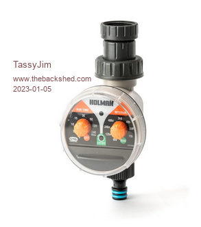

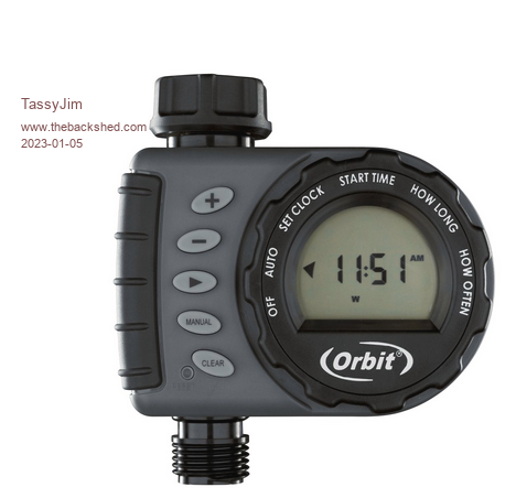

TassyJim![]() Guru Joined: 07/08/2011 Location: AustraliaPosts: 6603 |
I have some garden timers that run on 3V. They use a rotary ball valve driven by a small motor. The timer part is stuffed so I intend to repurpose the motor/valve "eventually". They rely on physical limit switches so not sure about the life-span. A trip to the garden centre might give you some inspiration. The voltage used varies a lot. ![]() This one is 3V This one is 9V ![]() My 3V ones are similar to this 9V one. And I know there is at least one Bluetooth one that is 6V. Prices vary from worth butchering to ridiculous. You are right about the solenoids, some require a low holding current, others are latching. Being packaged for the gardener, the details are limited. Jim Edit: This is a 4.5V valve: https://www.ebay.com.au/itm/164456997807 Edited 2023-01-05 06:35 by TassyJim VK7JH MMedit |
