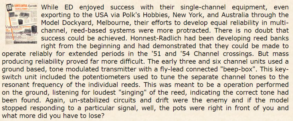

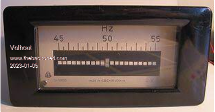

Hi Frank, In the world of "lots of processing power" this is pretty straightforward. In the MPEG compression (i.e. MP3) one of the first steps is to convert the audio signal into frequency bins. The compression happens on these bins. Afterward the bins are reconstructed to audio. If you look at the raw MP3 data over time, that could very well translate directly into this phonopaper.... How they did that in 1950. Well, that is not to difficult. Early electronics did filter tones based on "tone relays". This is like a normal mechanical relay, with adjustable contact arm. The contact arm would be tuned for a certain frequency (resonance). You would only need a single coil, with many different arms, each with their own switch contact. The arm that resonates at that particular frequency would make a contact. This is an article on a 1950's 6 channel RC system that used similar "tuned" reed relay contacts ![]() And THIS you probably have seen before.... ![]() Volhout Edited 2023-01-05 22:07 by Volhout PicomiteVGA PETSCII ROBOTS |

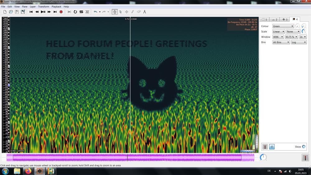

Ahhh sorry me again! What I forgot: Maybe this helps or can be some kind of workaround or idea; there are a lot of programs which can translate images to a sound spectrogram, you can make it visible again with a nice program (free) named "Sonic Visualiser" (https://www.sonicvisualiser.org/) or any other program you'd like. So with this program you can draw or convert any image to sound spectrogram: https://www.abc.se/~re/Coagula/Coagula.html YouTube Video Demonstration: https://www.youtube.com/watch?v=6yn2NrewEZA And with Sonic Visualiser (mentioned above) you can make it visible... Some example I created: ![]() And the wav: Coagula.zip Maybe some additional ideas for this whole audio spectrum idea! :) Greetings Daniel Edited 2023-01-06 03:02 by Amnesie |

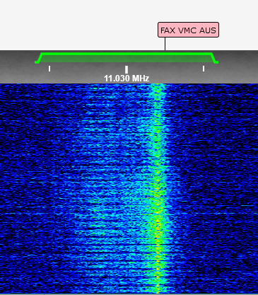

FFT displays have been used for many years as a tuning aid for FAX RTTY and slowscan TV and looking for signals over a wide frequency range. Usually referred to as "waterfall display" The picomite can do FFT so creating the image is easily doable. ![]() Example of a waterfall display of a HF FAX signal received this morning. (NOT using a picomite or any other 'mite) Jim VK7JH MMedit |

@Volhout: Thanks for your response! I have never heard of Ton Relay before. Do you have a link to a schematic drawing? I have also not seen your frequency display like this before. Very interesting - thank you!!! @CaptainBoing: I already knew the procedure (in German this is the Zackenschrift - unfortunately I don't know the English name for it). With this method, however, the frequencies are also already stored with it. @Amnesie: I once experimented with such a (maybe it was this) program a long time ago. You could encrypt any data, print it out, then scan it back in and transform it back. @TassyJim: This sounds very interesting!!! Would be great if you could do that with a PicoMite! My goal would be to print out sound signals in a spiral on paper like a record and then play them back with a rotating playback device. It is questionable whether a printer has the necessary resolution for this... Frank Edited 2023-01-06 06:16 by Frank N. Furter |

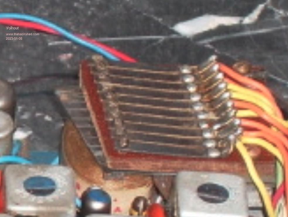

Hi Frank, ![]() The colored wires are the outputs. Under the brown phenolic you can see the 12 tone arms (different length, for different tones). And under the tone arms there is the single relay coil (yellow cylinder). The tone arms are very similar to the ones in mechanical music box (rotating drum with pins) Volhout PicomiteVGA PETSCII ROBOTS |
