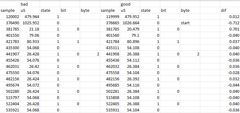

Posts: 6603
Posted: 05:44am 29 Jan 2023
I have been playing also.
I only have a DTH22 so no comparison possible.
It took a while for me to capture a bad reading but since I connected the CRO lead today I get a bad read every few hundred.
The following table is part of a spreadsheet of CRO data.
There is one difference.
With a bad reading the low time is always 40nano seconds shorter and the high time 40 nS longer.
The CRO samples every 4nS so it is not a sampling error.
The bad reading checksum calculates correctly and the values make sense so it is a reading the data problem.
The other timing of note is the 'low' state before each byte is 10uS longer than the other low state times. That doesn't get a mention in my data sheets.
The full data attached.
dht22.pdf
Ignore the sample column
uS is the time that the device stayed in either high or low
state is the corresponding high or low sate
bit is the bit determined by the length of a high state
byte is the 8 bits of the previous column
Temperature and humidity are X10

Posts: 6603
Posted: 11:37pm 29 Jan 2023
The pico firmware simply measures the 'high' time and any time greater than 50uS is a one.
The length of the low time is not measured.
This should be reliable and very forgiving of any timing variations.
My CRO did register some 4nS glitches but I put that down to the CRO and both good and bad readings had a similar number of these one sample glitches so I don't thing there are real glitches.
I will have to find time to take a lot more readings but so far, I cannot see what causes the occasional bad read.
