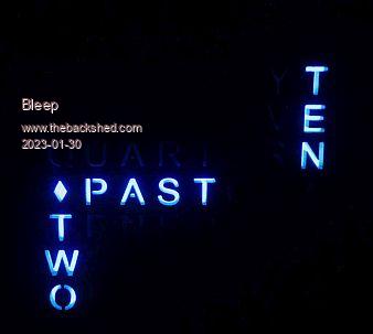

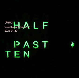

I'm back from being blown off the cliffs in Cornwall and a bit of crafting in Okehampton, so I've modified an old piece of my Python code(which I hate and have never used b4, but Python had a WS2812 driver for the Pi) which was running on a Pi3 to run on the Picomite, driving 64 WS2812 leds in cahoots, with the PIO.
It tells the time in words and as scrolling text, colour changing as it goes, semi randomly, it throws up a pattern, just for a bit of added interest.
This is using the old PIO Write command, but works great, not the new DMA command, which is next on my list to do, along with a lot of tidying up, as this was originally thrown together in a language I've never used and don't like and now converted to MMBasic.
Video of the clock working, telling the time.
Video in test mode, where it runs through all of it's patterns.
You may need to stand back to see the scrolling text reasonably, there is only so much you can do with an 8x8 display. :-(
