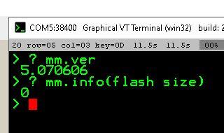

Hi,
This is my first post in this forum and I found something strange in mmbasic on pico.
When i type ? mm.info(flash) I get 0. But I can create files in the 5 flash slots.
What does mm.info(flash) mean? I have a raspberry pico board.
Greetings,
Nick de pe1goo

The only mention of mm.info(flash) that I can see in the latest manual is:-
"MM.INFO(FLASH SIZE)  Returns the size of the flash memory chip"
So "? mm.info(flash)" returns 0 as it doesn't exist.
Edit
That also returns 0 on beta 18. Something not quite right!
PS
Welcome to the forum.
Edited 2023-02-13 16:25 by phil99

MM.INFO$(FLASH)
Reports which flash slot the program was loaded from if applicable
zero should mean that the current program was not run from a flash slot.

  phil99 said  The only mention of mm.info(flash) that I can see in the latest manual is:-
Edit
PS
Thanks for the answer. mm.info(flash) makes sense... I don't use the slots, but mm.info(flash size) should return the amount of flash space available but it doesn't   . So as you discovered also we found a bug?
I did save a program in flash slot 1 and reloaded it from that slot, but mm.info(flash) does also return 0. Probably something not quite well?
Edited 2023-02-13 16:58 by nbrok

MM.INFO$(FREE SPACE) returns the free space in the flash drive.
MEMORY reports memory used and free for program space.
Posts: 3378
Posted: 07:07am 13 Feb 2023
So it would seem. Saved a short test prog. that included  "? mm.info(flash)" and  "? mm.info$(flash)" to Flash 3 and they still return 0 with "FLASH RUN 3"
("mm.info$(flash)" Gets tokenised to "mm.info(flash)")

Hello - welcome to the forums.
Yes, I am getting that report of zero also.  Not sure if I am on the latest PM firmware, I need to check that.
