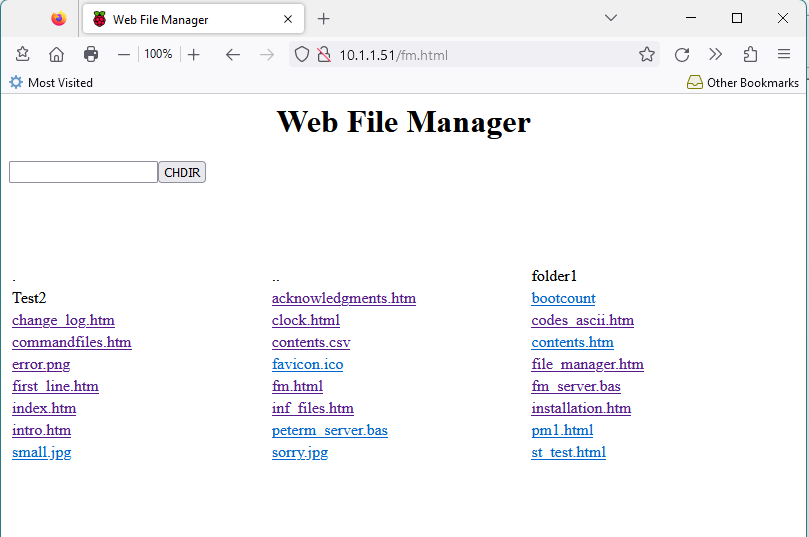

Two files are required. Both included in the zip
Tested on alpha12 ie before telnet. I will try it on the later alphas when time permits.
Still a lot to do and the CHDIR field does nothing for now.
This is a fast way to get data files and bas files etc off the pico.
No way to get files onto the pico...
web_fm.zip

Change your fm.html to
<html>
<head>
 <meta http-equiv="Content-Type" content="text/html; charset=utf-8"/>
 <meta name="GENERATOR" content="TheMonkeys">
 <style type="text/css">
   a{{width:30vh;display:inline-grid;}
 </style>
 <title>Web File Manager</title>
</head>
<body>
<h1 align="center">Web File Manager</h1>
<form name='f1' method='get' action='fm.html'>
<input type='text' name='T1' size='20'><input type='submit' value='CHDIR' name='B1'>
</form>
{showlist$()}
</body>
</html>
make the following changes to fm_server.bas
 inc n
 filename$(n) = "" (break tag  - it gets hidden by the browser)
between the dirs and files in makelist
then add
Function showlist$()
 Local n = 1
 showlist$ = ""
 Do While filename$(n) <> ""
   showlist$ = showlist$ + filename$(n) + Chr$(13) + Chr$(10)
   Inc n
End Function
This works for me.

Here's the working code for subdirectories:
the page:
<html>
<head>
 <!--link href="dom/core_c.css" type="text/css" rel="stylesheet"-->
   a{{width:18vw;display:inline-grid;}
 </style>
</head>
<body>
{filename$(1)} {filename$(2)} {filename$(3)} {filename$(4)} {filename$(5)}
{filename$(6)} {filename$(7)} {filename$(8)} {filename$(9)} {filename$(10)}
{filename$(11)} {filename$(12)} {filename$(13)} {filename$(14)} {filename$(15)}
{filename$(16)} {filename$(17)} {filename$(18)} {filename$(19)} {filename$(20)}
{filename$(21)} {filename$(22)} {filename$(23)} {filename$(24)} {filename$(25)}
{filename$(26)} {filename$(27)} {filename$(28)} {filename$(29)} {filename$(30)}
</body>
</html>
Add this to the declarations:
Dim sdir$="" ' subdir
Add this to the top of gotrequest (just the "NEW" stuff - indented code shown for reference)
 Local arg$(1,maxargs-1)
sdir$="" ' NEW
 For a%=1 To MM.Info(max connections)
and here's the updated makelist:
Sub makelist
  Local f$, n, k
  For n = 1 To 72
     filename$(n) = "" ' clear old entries
  Next
  n = 0
  f$ = Dir$(sdir$+"*",DIR)
  If sdir$ <> "" Then Inc n: filename$(n) = ".. ' : Print /+sdir$
  Do While f$ <]
     If Right$(f$,1) <]"." Then ' skip the ./..
     Inc n
     filename$(n) ="<a href='fm.piml?dir="+f$+"'>"+f$+"/"
'Print "_"+f$
     EndIf
     f$ = Dir$()
  Inc n
  filename$(n)="
  f$ = Dir$(sdir$+"*",FILE)
  Do While f$ <> ""
     Inc n
     filename$(n) ="<a href="+Chr$(34)+f$+Chr$(34)+">"+f$+""
'Print "-"+ f$
     f$ = Dir$()
End Sub

I created a sub directory "dom" and put "core_c.css" in it.
The code navigates into - and out of - the sub directory, shows the files, and as you can see in the commented line in my html, the browser successfully loads the file from there.
I'll leave it at that for now.
