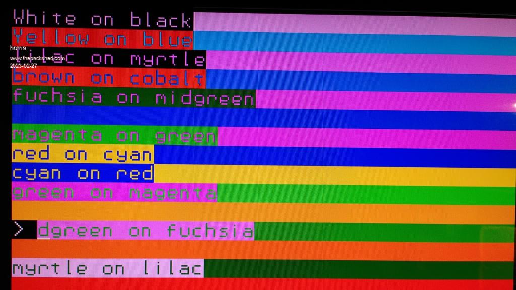

It also enables the PRINT and TEXT commands to use colour as long as the character locations meet the conditions above.
So, in mode 1, you can now go
TEXT 0,0,"Hello World",,,,rgb(red),rgb(green)
or
colour rgb(red),rgb(green)
print @(0,0)"Hello world again"
and it will do what you expect (in mono mode   )
If the output is not aligned to a tile boundary then the tile colours will be
ignored. So print @(100,0)"Hello world" will appear in whatever the tiles on which it is written are set to (typically black and white)

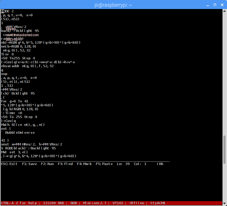

I have a problem when using the editor in mode 1.
If I change to Mode 1 and then Edit, the editor only shows some of the lines of the program and locks up solid, requiring a power off reset.
PicoMiteVGA MMBasic Version 5.07.07b19
OPTION SYSTEM I2C GP22,GP15
OPTION COLOURCODE ON
OPTION KEYBOARD UK
OPTION DEFAULT MODE 2
OPTION DISPLAY 30, 53
OPTION SDCARD GP5, GP2, GP3, GP4
OPTION AUDIO GP6,GP7, ON PWM CHANNEL 3
OPTION RTC AUTO ENABLE
OPTION DEFAULT FONT 7, 1
I have now found that it's the OPTION DEFAULT MODE 2 that is causing this, if I change it to OPTION DEFAULT MODE 1 all seems to be ok.
Edited 2023-02-17 05:40 by Bleep

Also, I accidentally copied and pasted all of this piece of code, using autosave.
vgabubble.bas.zip
I realise it's several slightly different versions of the same code, however once loaded the editor mangles it, the first 35 lines of code are fine and consist of a loop so the rest is never executed. However I didn't think the remainder should get corrupted like this, even though it shouldn't be there? the image is after scrolling down one page. I had done a flash erase and fresh install of b19 with no options set this is a terminal, but the VGA looks the same. This isn't particularly important as I shouldn't have done it! :-(
Any Ideas?

V5.07.07b20
PicoMiteVGAV5.07.07b20.zip
Fixes a bug if OPTION DEFAULT MODE 2 is set and you execute EDIT 1
