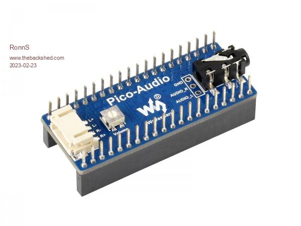

https://www.waveshare.com/wiki/Pico-Audio
Waveshare offers an audio module - is this suitable with the Picomite? I suspect not .. but think it should be the standard. maybe with an option??? "Option WS set".. I'm using the Waveshare 3.5 inch LCD board and I'm happy with it but some music or sound effects would make it some better.
all things are better with some  music... " Play Wave"

  Quote  Audio Expansion Module for Raspberry Pi Pico
Concurrently Headphone / Speaker Output
Overview
The Pico-Audio is an audio expansion module designed for Raspberry Pi Pico, which incorporates PCM5101A low power stereo decoder, and uses I2S bus for transmitting the audio signals. It supports a wide range of audio sampling rates, and allows headphone and speaker signal output at the same time.
Rev2.1 version: This product is an audio module designed based on Pico. It adopts a CS4344 low-power stereo decoder, an I2S interface to transmit audio, and supports a wide range of audio sampling frequencies. It also can be output by headphones and speakers at the same time.

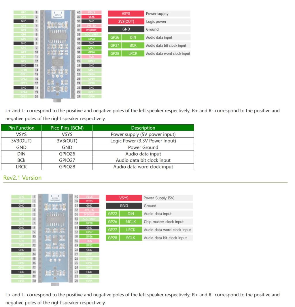

Rev2.1:
   Support audio sampling frequency of 2~200KHz.
   The chip has a built-in PLL, and the audio clock pin can obtain the main clock screen and automatically reduce the frequency.
   Onboard standard 3.5mm headphone and 4-wire speaker output interface, support audio output.
   Provides Pico sound card driver-free program, compatible with Windows, Linux and other systems.
   Pico audio player provided.

Posts: 3325
Posted: 08:00am 23 Feb 2023
PicoMite audio is PWM, that module is I2C so new audio CSUB may be needed.
Posts: 11662
Posted: 08:06am 23 Feb 2023
I2S not I2C. Much harder and only do-able with PIO
Posts: 9996
Posted: 08:20am 23 Feb 2023
Agreed.  I2S is totally different to I2C - it's a totally different protocol, despite looking similar in abbreviation.
I2C is a simple data exchange protocol.
I2S is a DIGITAL STREAMING protocol - very different.
Stick with the standard audio output via PWM and filter.

NPHighview
Joined: 02/09/2020
Posts: 222
Posted: 09:06pm 12 May 2023
Unfortunately, this is also the audio interface for the Waveshare Pico-Eval-Board. More questions about that board, its peripherals, on other threads.
