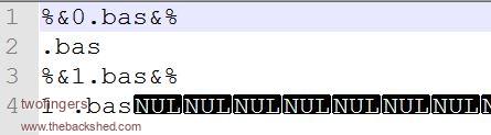

The first bug concerns the "DIR()" function, which seems to be affected by an "OPEN fname$ ...". This does not happen on the CMM2. I've written two bypass subroutines (ArchiveFiles_0 + ArchiveFiles_1) that work, but neither fully satisfy. The bug is demonstrated in the "ArchiveFiles_2" subprogram.

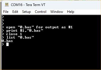

The second bug is related to the "Print#" command. It creates e.g. from >Print #1, "0.bas"< ---- >.bas<. So it omits the zero. This is not good. Here, too, the MMBasic for CMM2 works without any complaints.
My workaround for this bug is: Print #1,"%&"+"0.bas"+"&%".
Demo:
Open "testprint.txt" For output As #1
   Print #1,"0.bas"
Close #1
   Print #1,"0.bas"
   Print #1,"%&"+"1.bas"+"&%"
   Print #1,"1.bas"
Close #1
I get this with edit:
  Quote  %&0.bas&%
.bas
%&1.bas&%
1 .bas
> list"testprint.txt"
%&0.bas&%
0.bas
%&1.bas&%
1.bas
With Notepad++ (Windows)
At the moment I have no way of connecting an SD card. I just wanted you to be informed. There is a workaround, but it's not very elegant.

Your notepad version has been transferred with Xmodem from it loaded as a program
Use XMODEM S "testprint.txt" and it should be the same as LIST
The problem is that when you load it and edit it the file is tokenised with undefined  results
LIST just prints the ascii so is correct
Edited 2023-03-02 02:25 by matherp

  matherp said  Your notepad version has been transferred with Xmodem from it loaded as a program
Hi Peter, your assumption is correct. It's not a bug. Sorry! Learned something again ...
EDIT: Another observation (already mentioned in the first post): The editor of MMBasic for CMM2 behaves differently to Picomite and displays file contents correctly.
Edited 2023-03-02 03:18 by twofingers
