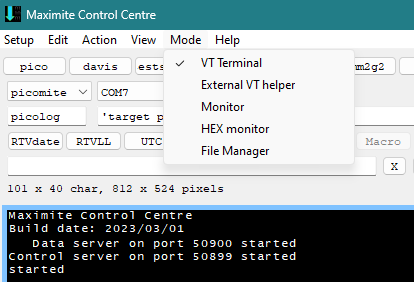

Posts: 6603
Posted: 07:57pm 01 Mar 2023
The normal mode is VT Terminal. All text from the device is sent to the terminal and keystrokes made in the terminal window are sent to the device.
Macros and command line text is also sent directly to the device. The command  line box has a command scroll back buffer which make sending repetitive commands easy.
Many system messages are also sent to the terminal window.
External VT helper assumes the an external terminal program such as TeraTerm is connected to the data port. All data is transferred between the attached device and the terminal program. Additionally, you can send macros and other commands etc from the Control centre without interrupting the terminal session.

Monitor / Hex monitor also assume a connected external terminal. MMCC will monitor and display text going between the terminal program and the attached device in ASCII or HEX.
This is very helpful when debugging VT control codes etc.
If TeraTerm is on the same PC as MMCC, connect TeraTerm to TCPIP localhost:50900

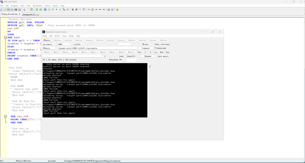

atmega8
Joined: 19/11/2013
Posts: 738
Posted: 09:34am 02 Mar 2023
Started Teraterm, connect to com8 of PicoW.
Works.
Configured  external VT Helper.
Tryin Upload fails:

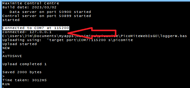

Posts: 6603
Posted: 08:16pm 02 Mar 2023
You have to connect TeraTerm to MMCC, not the pico.
connect TeraTerm to TCPIP localhost port:50900
I need to see where you have connected!
