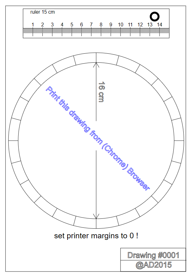

Creating diagrams as bitmaps can be a challenge without a result.
But we have the vector graphic option as SVG code and/or files.
Dim myfloat!=16.123
Dim myint%=999
Dim mystring$="The PicoMite Web is GO!!!"
Are defined but not found in the source code of simpleweb.bas,
because you find thes variables within test4.html under
<h1>{mystring$}</h1>
Test of a float: myfloat is {myfloat!}
Test of an integer: myint is {myint%}
Test of a string: mystring is {DateTime$(now)}
So WEB transmit page a%,"test4.html" interprets and replaces as an example {<h1>{mystring$}</h1>} by the content of the known
variable mystring$ into <h1>The PicoMite Web is GO!!!</h1> automatically.
That can be used to integrate SVG graphics directly within the a HTML file.
See
https://www.w3schools.com/graphics/svg_inhtml.asp
and
https://www.freecodecamp.org/news/use-svg-images-in-css-html/
But you can also create a separate SVG file and transmit by:
WEB Transmit FILE a%,"rulers.svg","image/svg+xml"
Here is a BASIC example manly created by Aat written in OliBasic for Android at
https://www.tapatalk.com/groups/rfobasic/generating-a-pdf-t6255.html#p47019
This example should be readable for BASIC programmers.
I have to explain that the function WORD$(GrTextDraw$,3,",") returns the third text part of the CSV string GrTextDraw$ delimited by ",".
One of the results
Happy coding
Gregor

  aFox said  PicoMiteWeb with SVG Graphics
But we have the vector graphic option as SVG code and/or files. ...
Very interesting!
  Quote  I have to explain that the function WORD$(GrTextDraw$,3,",") returns the third text part of the CSV string GrTextDraw$ delimited by ",".
It looks like the(CMM2)MMBasic Field$() function.
Returns a particular field in a string with the fields separated by delimiters.
'nbr' is the field to return (the first is nbr 1). 'string1' is the string to search
and 'string2' is a string holding the delimiters (more than one can be used).
'string3' is optional and if specified will include characters that are used to
quote text in 'string1' (ie, quoted text will not be searched for a delimiter).
For example:
S$ = "foo, boo, zoo, doo"
r$ = FIELD$(s$, 2, ",")
will result in r$ = "boo". While:
s$ = "foo, 'boo, zoo', doo"
r$ = FIELD$(s$, 2, ",", "'")
will result in r$ = "boo, zoo".
