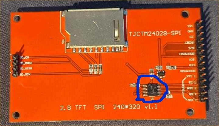

Can you (or anyone else) suggest a similar 2.8" LCD panel that's easy to interface with the Pi Pico and PicoMiteWeb?
Some buttons would also be handy, but I'm mainly interested in the LCD.
Thanks!
Posts: 11850
Posted: 06:18pm 19 Mar 2023
Easiest by far is this
Otherwise a ILI9341 off ebay but if you want touch make sure it has the chip fitted
