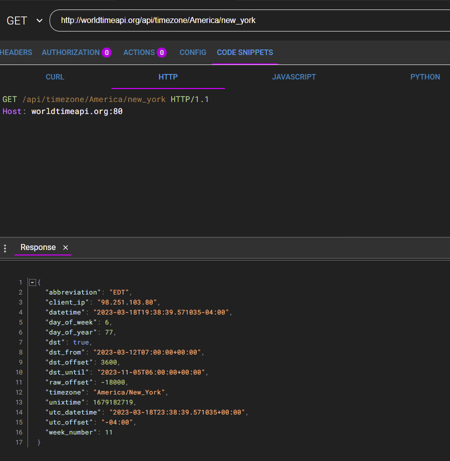

It feels like it should work...
WorldTimeAPI is a simple web service that returns the current local time for a given timezone as either plain text or JSON.
curl
"http://worldtimeapi.org/api/timezone/America/New_York"
And my code is as close to the SAMPLE code as possible for "reasons".

Posts: 6603
Posted: 01:33am 19 Mar 2023
DIM  GetRequest$ = "GET /api/timezone/America/new_york HTTP/1.1"+Chr$(13)+Chr$(10)+Chr$(13)+Chr$(10)
Case may be important. new_york all in lower case.
You need the 'HTTP/1.1" at the end
and you seems to need two crlf pairs.

I now GET the response... but annoyingly, it's not just JSON in the buffer, as I got all of the header information too so JSON$ will "barf" on it. (I mean, It does, as it's essentially not JSON data if it sees the header info too)
What the Client session gets back in the BUFF%() from the server is:

Posts: 11850
Posted: 11:12am 19 Mar 2023
LongString trim buff%(),LInStr(buff%(),"{")-1

Ok well... That *does* trim out the header... (Which was where I was headed with this...  so Thanks)
It seems ODD that the header gets captured on the GET REQUEST made by MMBASIC, but not on a CURL or an "Advanced Rest Client" request. (or are we SUPPOSED to capture header data in the GET request?)
I thought this would be a simple client API call example to add to my docs... but it quickly became troublesome.  Anyway... JSON$ is happy now as the BUFF%() array now does only have JSON data in it.
