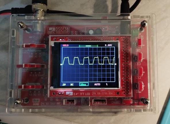

Hi folks,
In relation to the speaker thread I'm just poking around with my oscilloscope and found this signal on GP6 (and GP7) even without running any program on the PicoMite - is this expected even when the sound is quiescent ?
OPTION AUDIO GP6, GP7
I wouldn't put much faith in the shape of the trace (only its existence) as I'm still using a POS scope with POS probes - the management vetoed my "spending" on a proper one (because I wouldn't use it, and TBH this is the first time I've used my scope in 4 months), but has ackowledged that my upcoming 50th birthday will trump this .

Yes. This is a 50/50 output that generates a steady 3.3V/2 output voltage allowing the wave to swing either side
Posts: 6549
Posted: 10:38am 26 Mar 2023
A square wave of 50% duty cycle will give you a voltage of 3.3 / 2 after filtering.
So, yes, what you see is correct.

OK, thanks.

Thanks Peter, I knew some of this at a very vague level and I appreciate the extra effort to educate me.
My query was specifically with regards to whether the signal was expected when MMBasic was not actually requesting any sound be played, I now understand that it is - it is sufficient for OPTION AUDIO to be configured even if not used.
