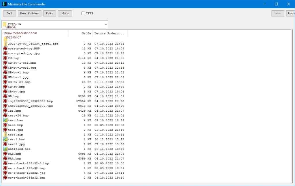

just installed V5.1.1, MMedit seems to work normal but with MMCC in filemanager mode i just see the PC files, not the files on the pico. File transfers from PC >>> pico work though.
This is how the filemanager windows looks like
Is there something i've done wrong?

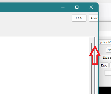

Posts: 6603
Posted: 08:45pm 06 Apr 2023
Your slider has moved to the right. Move it back to the centre and the picomite files will be visible.
If it happens again, send me a copy of your mmcc.inf file before adjusting it so I can try and find out why it happened.

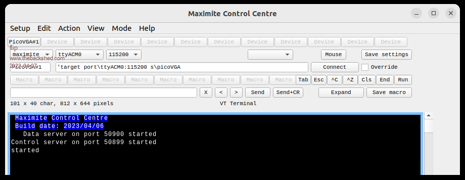

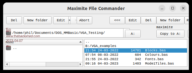

Just one problem with File Commander, looks like it's sending the first field (Time) instead of the file name.
> XMODEM SEND "07:54"
Error : The logical drive number is invalid
Maximum Errors. Transfer Aborted.

Posts: 6603
Posted: 05:03am 07 Apr 2023
Phil,
What device are you connected to. You have it set to "maximite"
You must set the correct device before opening the file manager.

Joined: 18/07/2016
Posts: 124
Posted: 05:10am 07 Apr 2023
Thanks Jim,
I can see the problem (I think)
that maximite seems to come back whenever I exit and re-run MMCC
I can't make the picoVGA 'stick'
Phil
Edit...I guess 'Save settings' doesn't over-write  the .inf? ...I can easily edit...learning as I go.
OK Saved the change in the MMCC.inf file.
It now shows up as 'picoVGA' fine
But no difference to the problem...still trying to XMODEM SEND the time as a file

Posts: 6603
Posted: 05:35am 07 Apr 2023
My Linux setup doesn't have that problem.
I will have to have a hting about it.
For now, change the mmcc.inf file so that picomiteVGA is type0 and maximite type6
[Device types]
; FamilyList\ Fname|autostart|autoend|autoName|drives|xmName|filesCMD|filesAll|flash|fnstart
Type6 = maximite|auto|\003|0|2|2|files|0|0|0|0
Type1 = micromite|autosave|\026|0|0|1||0|1|0|0
Type2 = micromite+|autosave|\026|0|1|3|files|0|1|0|0
Type3 = pi-cromite|autosave|\003|0|1|1|files|0|1|0|0
Type4 = cmm2|autosave|\027[12~|1|1|3|ls|0|1|0|30
Type5 = picomite|autosave|\026|0|2|1|files|0|1|1|30
Type0 = picoVGA|autosave|\026|0|2|1|files|0|1|1|30
Type7 = WEBmite|autosave|\026|0|2|1|files|0|1|1|30
Type8 = command|||0|1|0|files|0|1|0|0
That should get things working while I think...

Joined: 18/07/2016
Posts: 124
Posted: 05:55am 07 Apr 2023
Thanks Jim.
That worked. I do things haphazardly a lot so very likely I may have missed a step.
Here is my 'problem' version
Device types]
Type0 = picoVGA|auto|\003|0|2|2|files|0|0|0|0
Type6 = picoVGA|autosave|\026|0|2|1|files|0|1|1|30
It is very useful software thank you for your help.
Phil
Posts: 6603
Posted: 06:38am 07 Apr 2023
The last entry on each line is the file name start (fnstart).
The maximite starts at character 0 and the later devices swapped the order and start the name at chr 30 in the output of FILES.
Thinking its a maximite has other similar differences that will bite you.

thanks, moving the slider did it ... so easy. And it survived the last reboot, so seems to be just my fault. I apologize, but I just didn't see the slider on the far right.
Gerald

Posts: 6603
Posted: 11:59am 07 Apr 2023
  ville56 said  Hi Jim,
Gerald
One thing I have learnt is that Windows (and Linux) can do strange unexpected things.
I have changed it so you can't slide it all the way over. That way users can see what to do.
