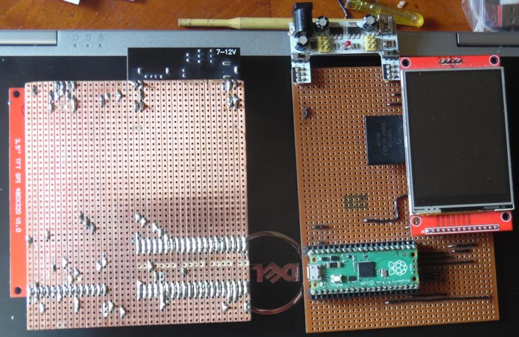

Hi,
I had a déjà vu experimenting with the pico and a spi display with touch screen.
It didn't work as expected. Why? I didn't held me at the HF rules I learned as Ham-radio amateur. The spi is working at 25 MHz and with long thin wires you generate several noise problems on the spi bus. The power (3V) gives a smaller noise ratio then at 5V and amplifies the problem. On a designed PCB the problem doesn't occur because of the copper-pour shielding.
The problem was the gui test lcdpanel command. It shows moving circles and generates a lot of SPI traffic. The first minute all seems working fine, but after that the display flashes white and doesn't recognize any command until the Pico is reset or power down upped.
This far I only experimented with microcontrollers lower than 35 MHz clock and 400 KHz spi bus. So simply soldering a pico with wires on a experimenters PCB can generate a lot of problems
Then I see a contribution from Tom with his Pico bintendo.  Nice photos but he doesn't show his wire side.   . I'm curious how he did it.
Edited 2023-03-27 15:59 by nbrok
Greetings,
Nick de pe1goo
Posts: 6104
Posted: 06:23am 27 Mar 2023
Hi Nick,
I did not check recently, but I recall SPI worked at 16MHz. Maybe the speed was increased for faster drawing on LCD. But for a "shared" SPI bus (SD card, touch, LCD) 25MHz is quite high. That definitely needs carefull design and routing.
Good observation ! Thanks.

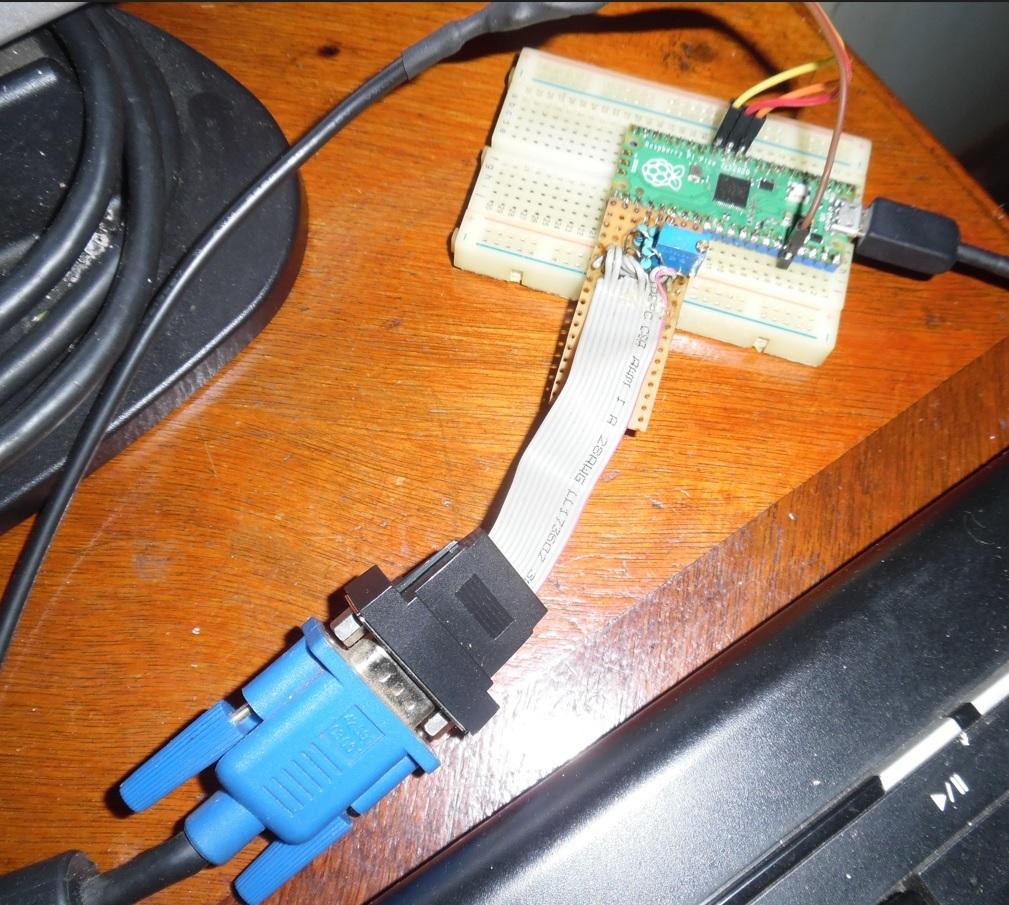

Posted: 01:14pm 27 Mar 2023
I am mostly using wires for my LCDs (20-30cm long soft silicon wires). Have not noticed any specific problems...except sometimes conneting to wrong pins.
Posts: 2807
Posted: 03:06pm 27 Mar 2023
I've had no problems with spi touch lcd with sd card on strip board, maybe lucky.
Posts: 11848
Posted: 03:53pm 27 Mar 2023
  Quote  I've had no problems with spi touch lcd with sd card on strip board, maybe lucky.
That is much nicer wiring than using flying leads and effectively not much different than a PCB.
The only change I would make is to cut all the LCD tracks as close to the connecting wires as possible so there is the minimum track with the signals on them

Posts: 2807
Posted: 06:57pm 27 Mar 2023
I will cut the unused tracks as the capacitance between tracks could cause problems.
There's "vero" that looks like bread board but it costs more. Great for transferring bread board to something more reliable. I find bread board tracks too short ie not enough holes per track. I never got problems with bread board ...as long as you don't move it :)
"vero" has been around ages but I can't find a "spot face cutter" so use drill bits to cut tracks.
There's a pc vero designer, Veecad but it was easier to use pen and paper.
You can't use vero for a vga connector.

nbrok
Joined: 13/02/2023
Posts: 62
Posted: 03:25pm 29 Mar 2023
Hi,
I just received my last pcb design from Aisler PCB service and here I have no problems with the LCD.
Here a photo:
Edited 2023-03-30 01:34 by nbrok
Greetings,
