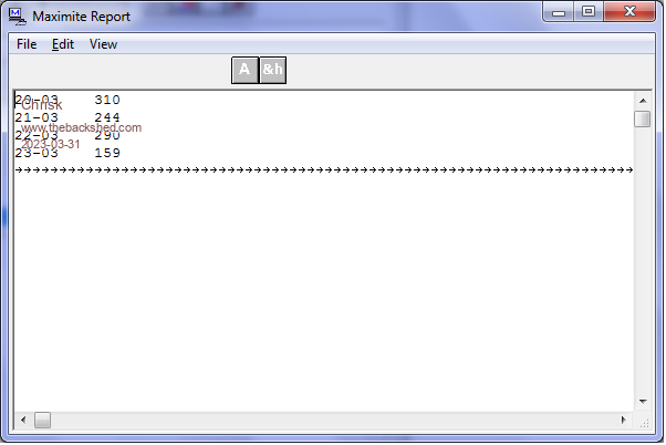

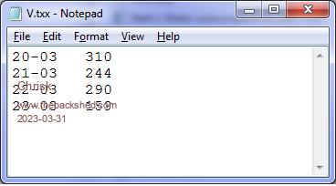

Problem 1
When I transfer a short 4 line file to my micromite 64 the received file has at the end a series of characters. This upsets by data reading program.
It has just occurred recently. Any ideas please.

  Quote  Problem 1
When transferring files using XMODEM, the file is padded out to a multiple of 128 bytes.
The padding character can be either chr$(0) or chr$(26). The standard allows either.
That has always been the case.
One way of removing the extra characters it to run the program on the 'mite.
You may have to edit it to include files with the correct extension for your data files.

In MMCC.inf you can change the pad character but if you change it to anything other than 0 or 26, XMODEM will fail.
Look for this line in the general section
Xmodem pad character = 0

The strange thing is that Problem 2 wasn't a problem until recently.
And somehow I must have avoided the padding because the files were always greater than 128 bytes.
Chris K

The file gets padded to a multiple of 128 bytes.

Each packet of a xmodem transmission is 128 bytes long, the last one is padded to make it 128 bytes if it is less than 128 bytes. It's part of the spec and has always been that way.
I can't remember the details now but it had something to do with CP/M file block size. It's that old. Look it up in Wikipedia if you want more info.
