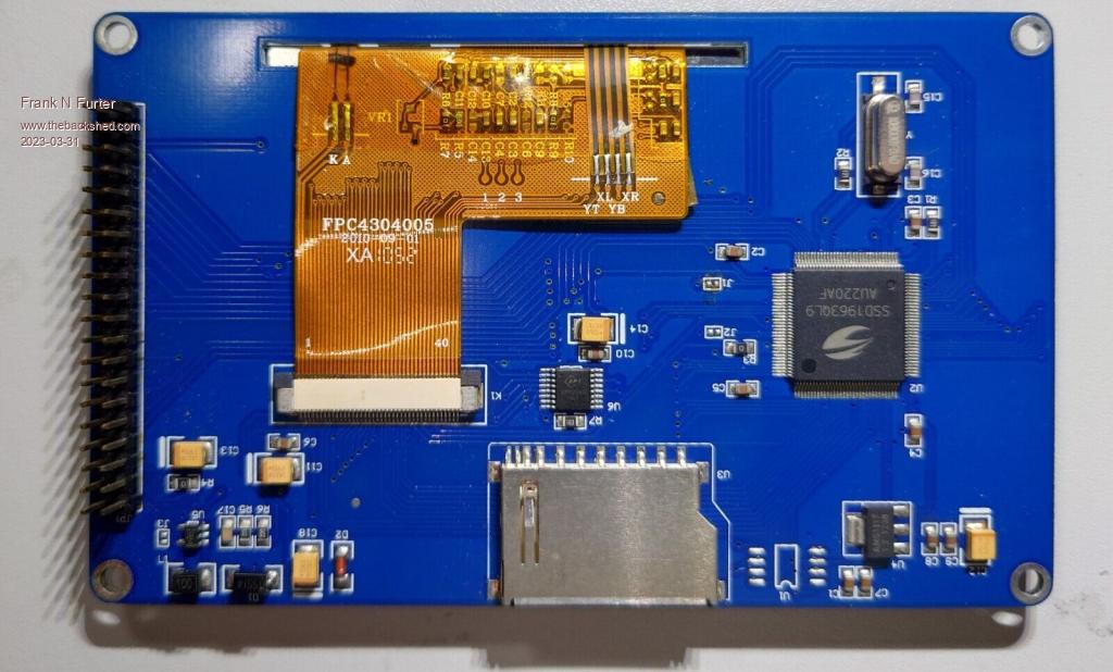

Hi,
can this SSD1963 display be used with the PicoMite?
Unfortunately, there are no pin assignments printed or available... :-(
THANKS!
Frank
Posts: 11668
Posted: 06:57am 31 Mar 2023
Assuming it uses the standard pinout - then yes, see the manual for connection details

  Quote  Then I will get the display and try it out!
Start by buzzing out connections to the SDcard and xpt2046 chip to see if the wiring corrresponds

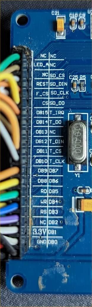

Perhaps be a little cautious about the orientation of the board; your image shows the circuit board overprint to be upside down.  It is unlikely that this board is intended to be in this orientation.  Perhaps the connector on your board is on the opposite side to the one shown by Peter.  Checking that the ground connection corresponds to the standard diagram might be sensible before making other connections. The connection is likely to be standard but which way up?

@circuit:
You are right! The orientation of the plug is unusual - that's why I asked here first. I have now ordered it - let's see if I can measure the pinout out...

circuit

Be aware that some SSD1963 boards have solder jumpers to select the operation of the backlight.  Yours has J1, J2, J3 jumpers which are apparently open.  These may have some functionality in backlight control.

Frank N. Furter
Joined: 28/05/2012
Posts: 1143
Posted: 12:13pm 06 Apr 2023
First realization: The display has a default assignment, as posted by Peter!
Let's see when I get to connect the display...
Thanks to all!!!
Frank
