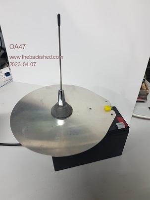

As mentioned earlier I am using a number of these units in a micromite network and was wondering if there is a simple way of measuring the reflected power from the antenna. I am cutting the antenna at 173.1mm to suit 433Mhz 1/4 wave length and was wondering if I was doing it correctly.
I have SWR meters in the shed but with FSD settings of 1KW,10W & 1W I cannot get enough power from the low power units to measure the reflected power.
Any suggestions greatly appreciated.

The nanoVNA, VNA = vector network analyzer can check antenna resonance.
 nanovna.com is one of many versions found on searching "nanoVNA"

It all depends on your ground plane and antenna diameter but I would usually cut mine to 16.5cm (0.95 * quarter wave)
The nanoVNA is good but a bit expensive of a one time use.

Jim, I initially used factory made plastic covered antenna but the birds with the bent beaks found them too attractive and destroyed them very quickly. I decided on this format which does win the battle with the birds.
My measurement is taken from the plate to the tip of the antenna.

I wouldn't get too worried about the dimensions. Either will work well enough.
IF you want to try something that doesn't need a ground plane/bird perch, look up J-pole.
