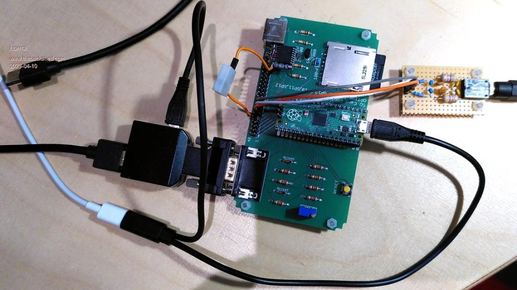

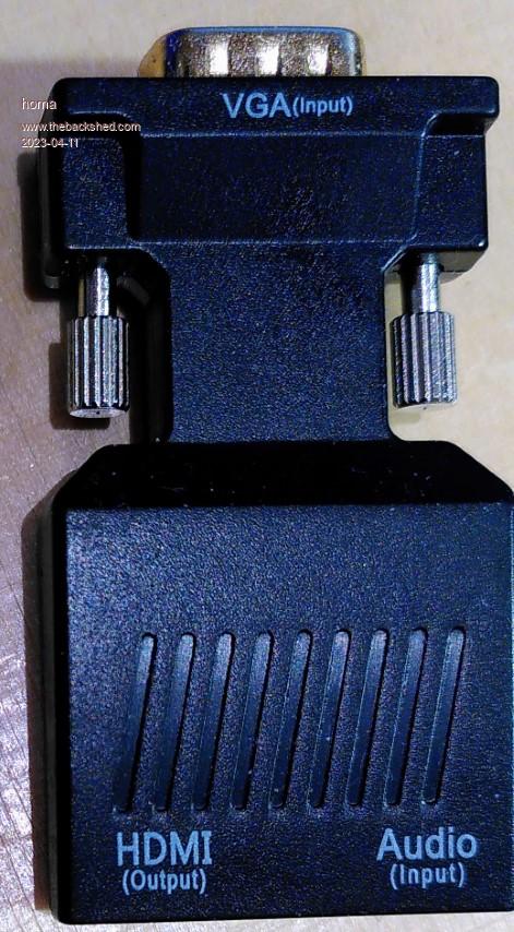

I bought this adapter here for 10 EUR from Amazon and the adapter works for me on the PicoMiteVGA with my monitor.
https://www.amazon.de/dp/B08SR7FCRM
However, since the adapter needs USB power, I connected the two devices with a USB-C Y-cable to USB-Micro ;-)

homa
Joined: 05/11/2021
Posts: 651
Posted: 08:52pm 10 Apr 2023
Yes the Amazon image is incorrect. But the delivered adapter has the correct labelling and an audio input! ;-)

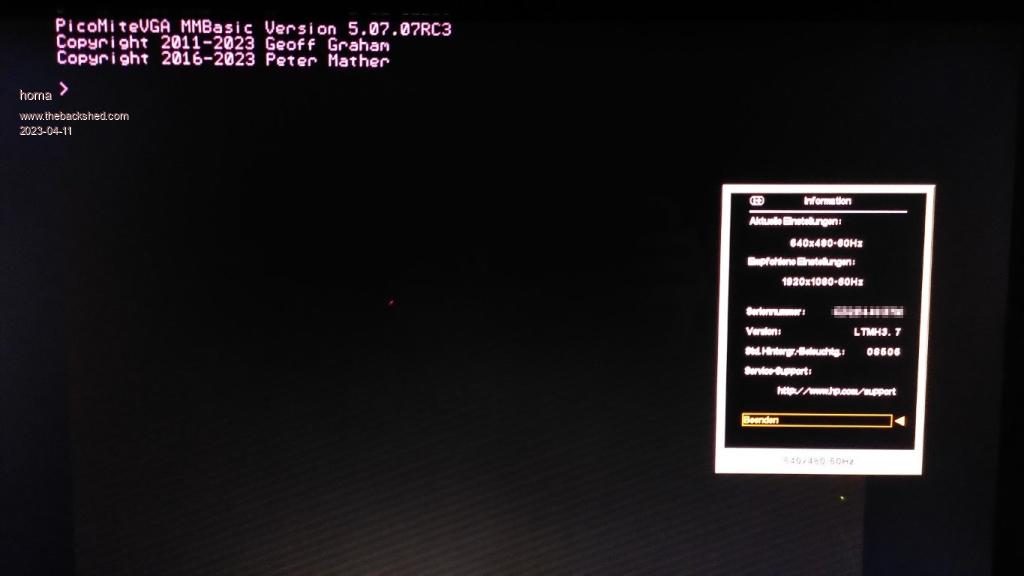

homa
Joined: 05/11/2021
Posts: 651
Posted: 09:39pm 10 Apr 2023
  Plasmamac said  What screen mode is working?
Both. Mode 1 and 2. Or do you mean the resolution on the monitor? See picture ... 640x480-60Hz
