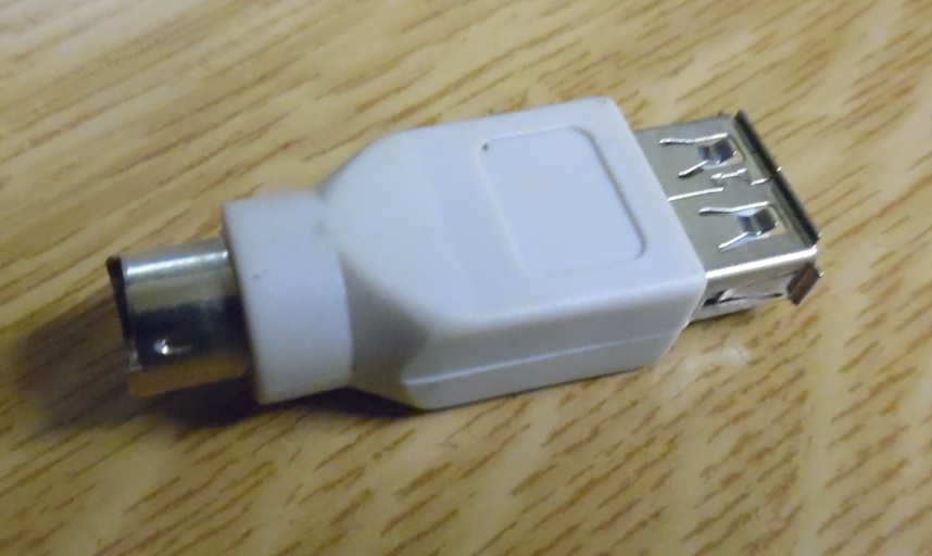

I use one of these
Amnesie
Joined: 30/06/2020
Posts: 763
Posted: 09:49pm 15 Apr 2023
Hi Dave, thanks a lot for this link! REALLY usefull.
@ stanleyella
Yeah I have one too, but this works ONLY if your keyboard supports PS/2. Dave shows how it's done if your keyboard supports no PS/2 at all.

Posts: 2807
Posted: 10:36pm 15 Apr 2023
I used the adaptor years ago because the pc had ps2 sockets and I didn't want to use all the usb sockets. I never tried with picomite, no ps2 socket.

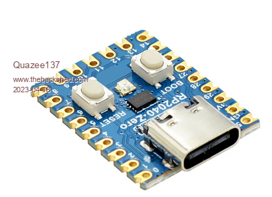

I got two of these coming to try out for this.
 and two of these.
I have boxes of true USB keyboards for up coming project.

@ Quazee137 - Yes, I have a handful of those WS RP2040 Zero modules myself now.  They are very small, yet run PicoMite MMBASIC just fine, and they are also cheap and readily available. They also use a USB-C connector, which is a bonus.
Posts: 8978
Posted: 07:01am 18 Apr 2023
I was just looking at those - over twice the price of a normal Pico here in the UK (Amazon, but out of stock). About the same price as a Pico if you buy from AliExpress.
You can saw a Pico down to about 37mm. :)  You don't need anything south of the clock.
