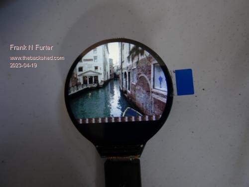

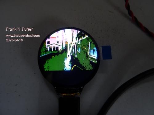

Hi,
I have tried the demo from Peter ( https://www.thebackshed.com/forum/ViewTopic.php?FID=16&TID=15427 ). Unfortunately, the background image is not included.
I have therefore experimented with my own images, unfortunately with only moderate success... Diese beiden Bilder zeigen mein Problem, hier die Originale:
DSC03042.zip
...and this is how the JPG looks like:
...and this is the BMP:
This is how it should look:
I have the current beta version - ? mm.ver says 5.07.07
What's going wrong here? I have tried other images, also with different image programs...
Frank

I tried LOAD IMAGE and LOAD JPG. Can you give me "face" from your demo???
How can I generate RGB121 pictures?
@Phil: With your program nothing happens at all on the display - the clock hands from the previous program are still shown...
At the first attempt (to save the previous program), XMODEM SEND gave the error NOT ENOUGH MEMORY!?
Only after an aborted XMODEM RECEIVE I could send my previous program successfully...
Frank
Posts: 11847
Posted: 10:36am 19 Apr 2023
You haven't answered the question. If you are loading an image to a framebuffer or moving it to a framebuffer it is compressed to RGB121 - the same colour set as the PicoMiteVGA. To create a RGB121 image to your specification you would need to tell your photo program what the VGA palette is and get it to just use those colours but you are still limited to just the 16.
If you are not using the framebuffer then there may be a bug but please just reset the Pico and then load your image from the command line - nothing else - is it OK then?
My image is not useful. It is a greyscale image that I have manipulated and just has the dial markings

The Image has more Colors than the Pico can display
Here is an Online Ditherer, where you can save (copy and Past) a Custom Color Palette and it dithers in many different ways:
https://ditherit.com/

  Quote  The Image has more Colors than the Pico can display
I don't think so - the image is displayed properly after the RESET.

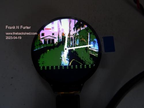

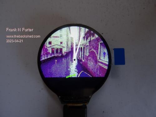

If I start your program, quit (CTRL-C) and call LOAD JPG "DSC03042", nothing happens. But if I type FILES before that and then LOAD JPG "DSC03042", the system crashes and reboots. If I then enter LOAD JPG "DSC03042", the image is displayed correctly.
When I start the program again, the image is displayed incorrectly again. During this procedure, the OPTION AUTOSTART ON function was apparently also lost...
This is reproducible with RC4 and RC5 for me.

OK Let's go through this bit by bit
  Quote  If I start your program, quit (CTRL-C) and call LOAD JPG "DSC03042", nothing happens.
This is because the image is being written to a framebuffer and not the screen after you ctrl-C out of the program. Framebuffers need to be understood and treated with caution.
  Quote  But if I type FILES before that and then LOAD JPG "DSC03042", the system crashes and reboots.
This is a bug that I think I have found and fixed in RC6. Please let me know once posted
