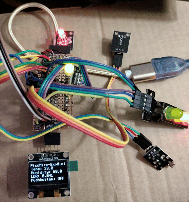

jaybec's post in the "I have a dream" thread gave me an idea: Phone, cable, pico, and -- the missing ingredient -- Terminal app The "ask"
The cell phone terminal app--USBTerminal--that he suggested works well--available on Google Play.

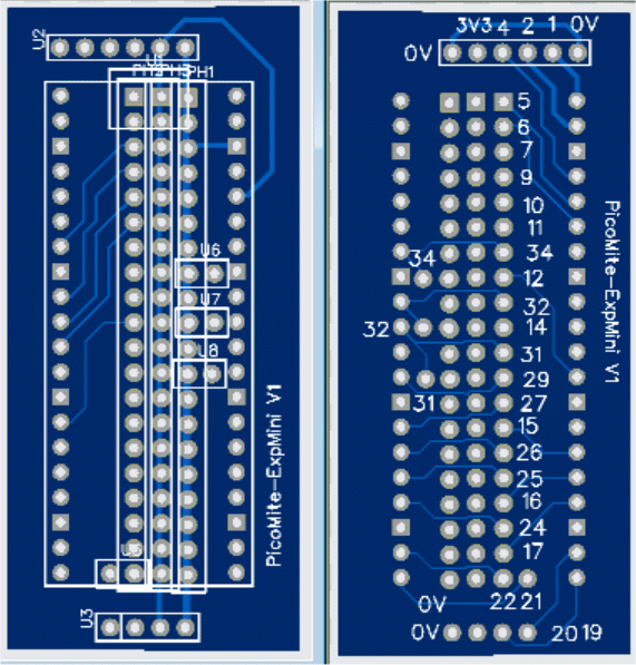

He included "breadboard", but I thought, why not a PCB which is little larger than the Pico itself? So I wired up a perfboard example:
Here is the layout:
                              G           G                                   + -

The columns at the right represent 3 columns of headers placed underneath the PicoMite. In conformity with many of the sensors/switchs in the 37-in-1 kits, 3V3 is the center column, with 0V and signal on either side. The three ADC pins also appear outboard of 0V, also following the 37-in-1 convention. In addition, I wired for a 128x64 I2C display at the bottom, and a rotary encoder at the top (which, with the addition of another 0V pin also allows a 4-pin RGB LED).
I didn't wire all the pins on the perfboard, because it was very fiddly, but the sensors shown are wired.
Here's a (poor quality) 2-minute youtube video of the board being exercised--run off of a cell phone using USBTerminal: PicoMite-ExpMini
I made a PCB--a couple of hours work in EasyEDA (no schematic--because it is simple, I drew it straight to the PCB):
Gerbers * are here--$6.62 for 5 from JLCPCB with slow boat shipping:
PicoMite-ExpMini_2023-04-21_Gerber.zip
