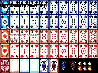

I may need a little more information regarding the format that a BMP file needs to be in to be displayed correctly by the LOAD IMAGE command.
I have a 16 colour indexed BMP file that I created in the GIMP (using the palette that was discussed in another thread) and when I load it using LOAD IMAGE, all I get is the black portions of the image displayed in green (though in reality, probably myrtle).
The original image is larger than the display, I am in Mode 2, should that matter?
I have also tried it in Mode 1 and got the same result, only in Black and White.  The image is also corrupted horizontally, staring to display about 1/3 across the screen, and then wrapping back around to the start about 2/3 of the screen across.
I've uploaded the bitmap for those that may like to try and re-create the issue.
Any help appreciated.
Mike.

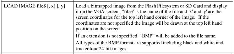

The good news is that I found out how to fix my problem.  I re-saved my indexed BMP file as an RGB format BMP file and it loaded exactly as expected.
So sorry @geoffg and @matherp, I'm not sure if it's a bug, or a feature, but unfortunately the statement in the manual that LOAD IMAGE supports all formats of BMP files doesn't seem to be the case.  So it's either a change in code or a change in the manual.  No guesses which is easier.
Here is the RGB version of the file that worked correctly.
The down side of this solution is that my 50K indexed BMP file became a 300K RGB BMP file.
Mike

Posted: 08:24am 29 Apr 2023
The firmware definitely supports indexed files as I've been using them recently and even supports compressed indexed 16 colour files

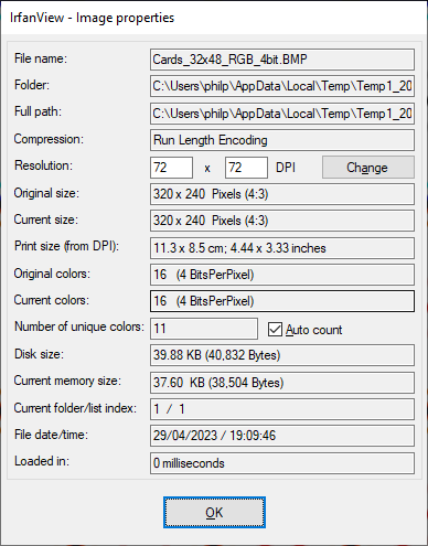

That displays correctly on my VGA.
Used
save compressed image "Cards_32x48_RGB_4bit.BMP"
Cards_32x48_RGB_4bit.zip
Now it's 40kB
Edited 2023-04-29 19:13 by phil99

IrfanView and Paint can display it ok but black & green on the pico.
The size is too big, 416 x 240 pixels. 320 x 240 max.
For processing your 24 bit images put them on a SD card and use the PicoVGA 'Save Image' to convert them to 4 bit. 'Save Compressed Image' uses run length encoding to shrink them further.

Phil, your conversion worked. I was able to load the BMP and it shows all cards from Ace to 10, and some rear sides and jokers. It does not show the king, queen and jack.
That must be in the par you did not convert... (320...416)

  Volhout said  <snip>
The image is wider than 320, and so it's not displaying those portions that don't fit on the display.
If you switch to Mode 1 and then display the image, you will see the whole image, but only the B/W portions.
I'm now trying to work out how to display the individual cards.
One plan is to load the image into the non-visible framebuffer and copy portions of it to the visible frame buffer.  My concern here is that the image will not fit in the framebuffer because it is larger than the display size.
A second option is to extract each card into it's own file and then load the cards on demand.  This option will suffer a speed penalty, but that may not be an issue in a card game.
We'll see what I can come up with today.  I felt like I had achieved a goal when I was able to load and display the coloured image in Mode 2.

Posts: 3378
Posted: 03:56am 30 Apr 2023
'Save Compressed Image' was added during development of Version 5.07.07. The amount of compression varies wit the amount of detail. Large areas of uniform colour compress very well. The image of the cards has a lot of detail so the size isn't much smaller.
I think Version 5.07.06 should however be able to display them.
Neither 'Save Image' nor 'Save Compressed Image' can process anything larger than the Frame Buffer which is 320 x 240 pixels in mode 2.
'Load Image' has the same limitation, expect odd results if you over-flow the Frame Buffer.
Your oversize indexed image could be cut in two to see if it can display correctly.
Edit.
I cut off the last 3 columns of cards (using IrfanView) and it displays correctly on the VGA now, though I don't know if it retained the indexing. As all the cards are the same size they can be easily separately displayed using multiples of their dimensions to select them.
IrfanView is very flexible and can do batch processing of a large number of files to convert to a specified size, colour depth, aspect ratio etc output to any image type. Once you get it set up it does the lot in one hit.
Edited 2023-04-30 14:24 by phil99
